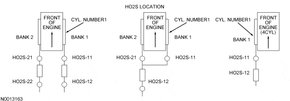

wrong bank 1 is the drivers side. and sensor 1 is the one before the converter sensor 2 is after the converter.
Where do you think that cylinder #1 is? bank 1 is the same side that cylinder #1 is.

and yes bank 1 is passenger side, sensor 1 upstream, not to bad to change, if thats the problem.
