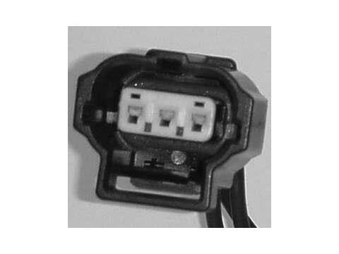

-i installed a Motorcraft Alternator.
-Installed new Ford/Motorcraft battery.
-Replaced Alternator pigtail connector with a Ford splice kit.
******Will pick up car in AM and will update everyone.
Lincoln LS “Check Charging System”
Car is repaired and operational!!
FYI:
~Installed Motorcraft Alternator.
~Installed Motorcraft Battery.
~Installed Ford pigtail connector onto alternator.

This resolved all Charging Issues-
Ford pigtail connector to alternator—-
~Also Installed Motorcraft Alternator
