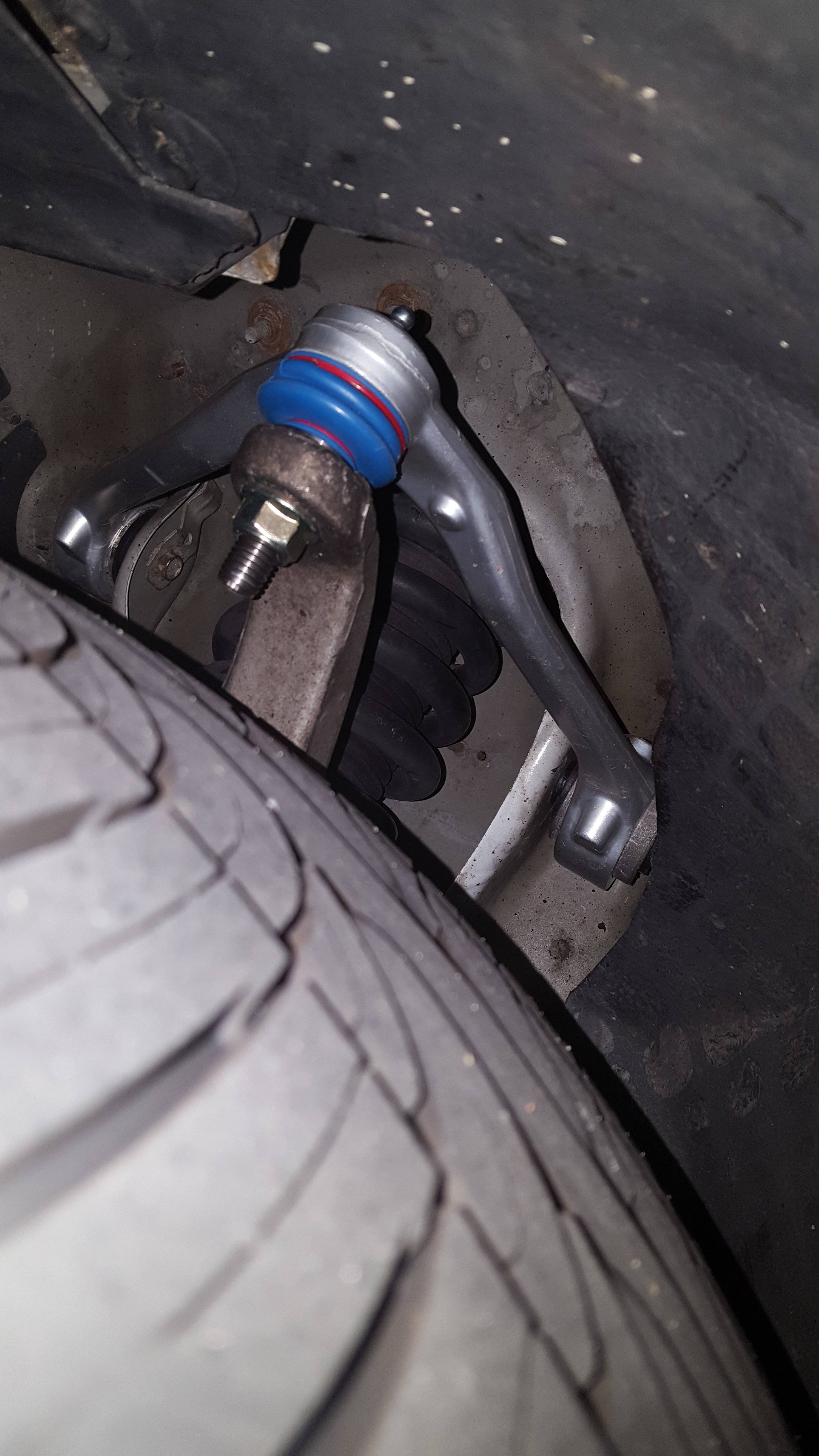

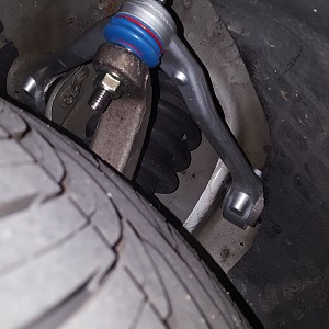

Was there any reason for you to replace the upper arm and bushing. I have an 04' with 41k miles on it and it has a slight shake on freeway speeds above 65 mph.
The car was making lots of creaking noises when turning and going over bumps. A visual inspection showed that the boots were torn, which meant they were probably shot. After replacing, 95 percent of the noises stopped.
