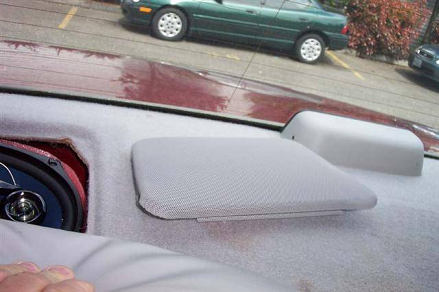

How to replace them
(1) Pry off the grill in the back. There aren't any screws, just be careful not to tear the grille fabric.
(2) Remove the four screws at the four corners.
(3) Remove the speaker itself, disconnect the wires.
(4) Drop in the new speaker. Notice +/- is not marked on it.
