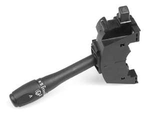

    This is the switch which controls your signals and your wipers.

    The multi-switch is only held in place with 2 Torx screws. It has 2 plugs with many wires in each. One is for the wiper circuit and the other is for the signals and the high beam.
    Replace the switch and make sure the thick cable, which has the 2 above-mentioned plugs, sits on top of the switch and not on the side. This will make replacing the upper steering column cover much easier.
