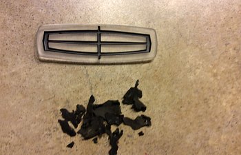

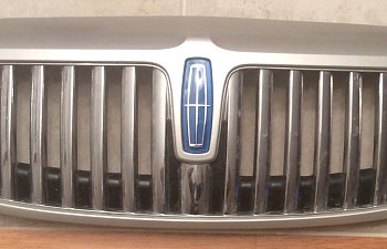

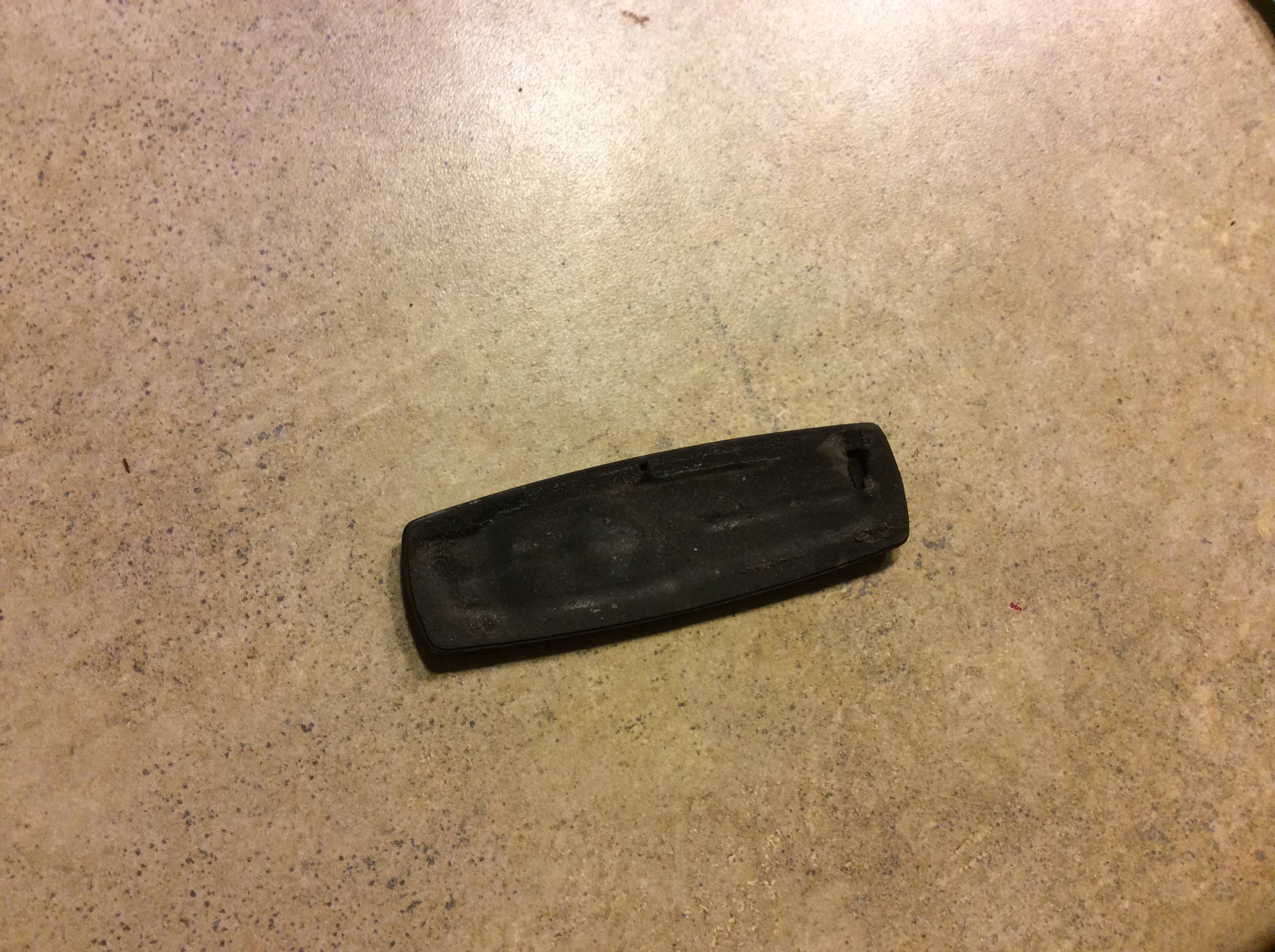

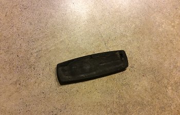

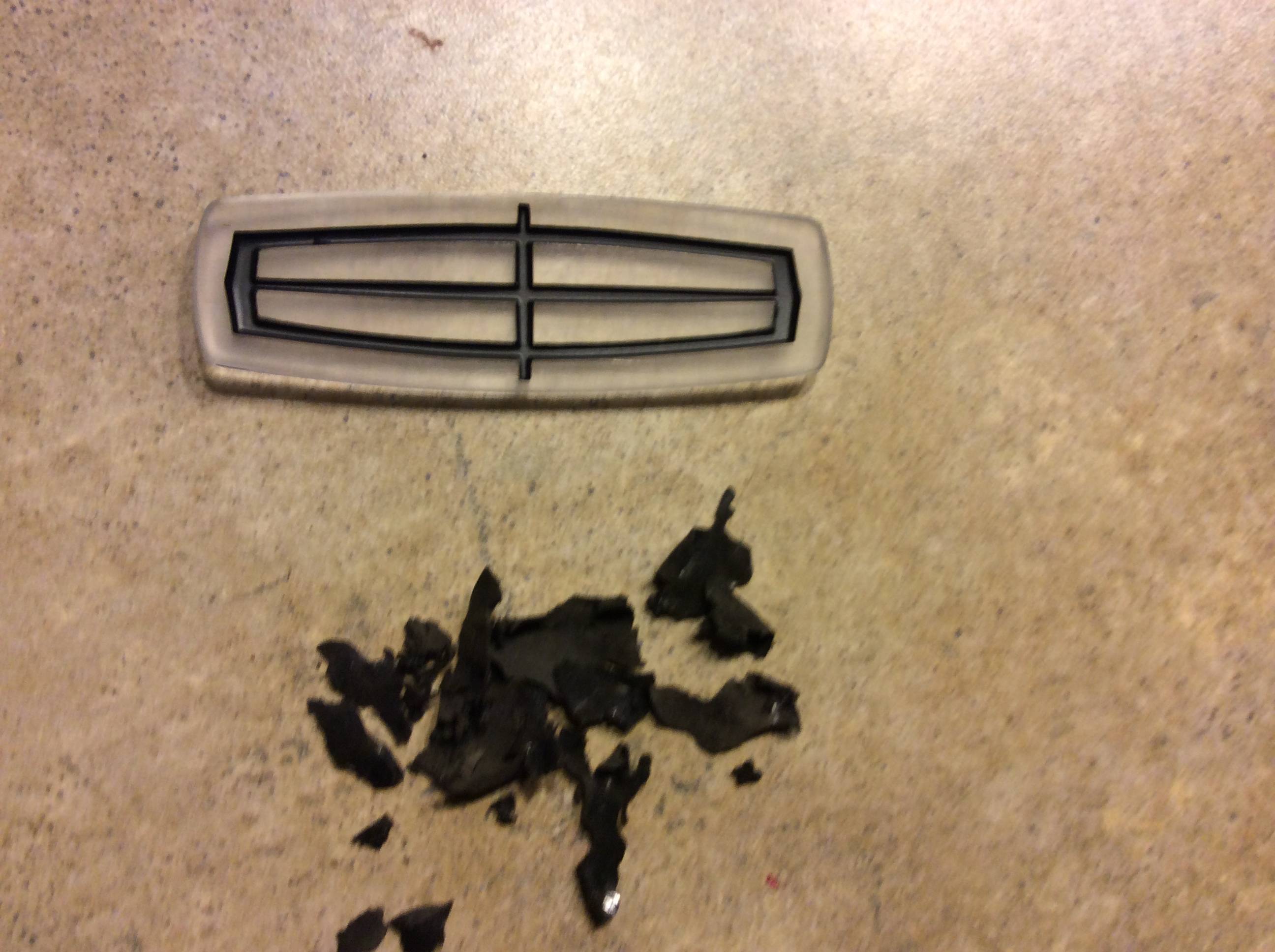

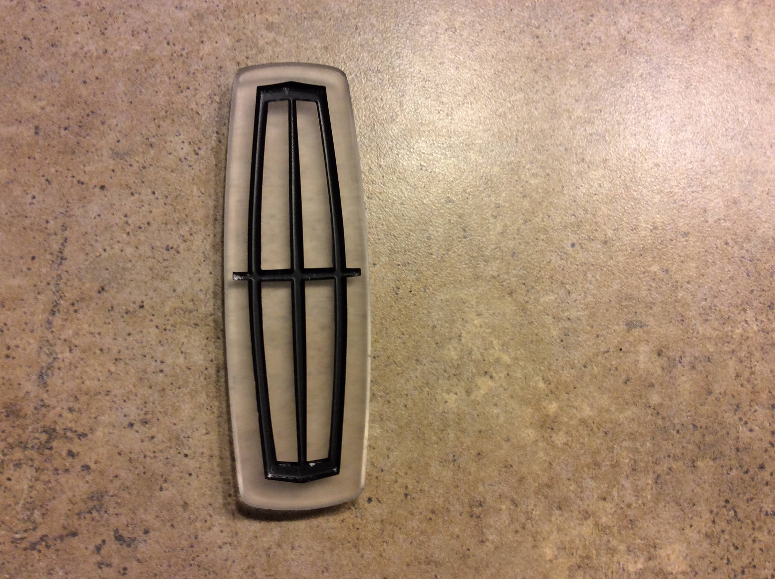

    Remove adhesive from back. Finger nail or flathead screw driver works good.

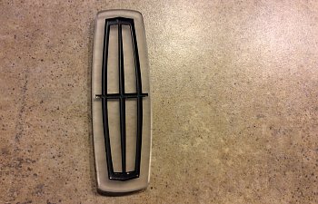

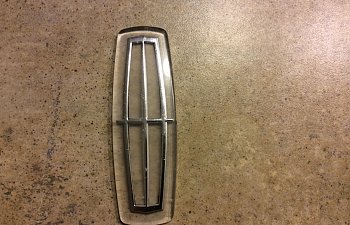

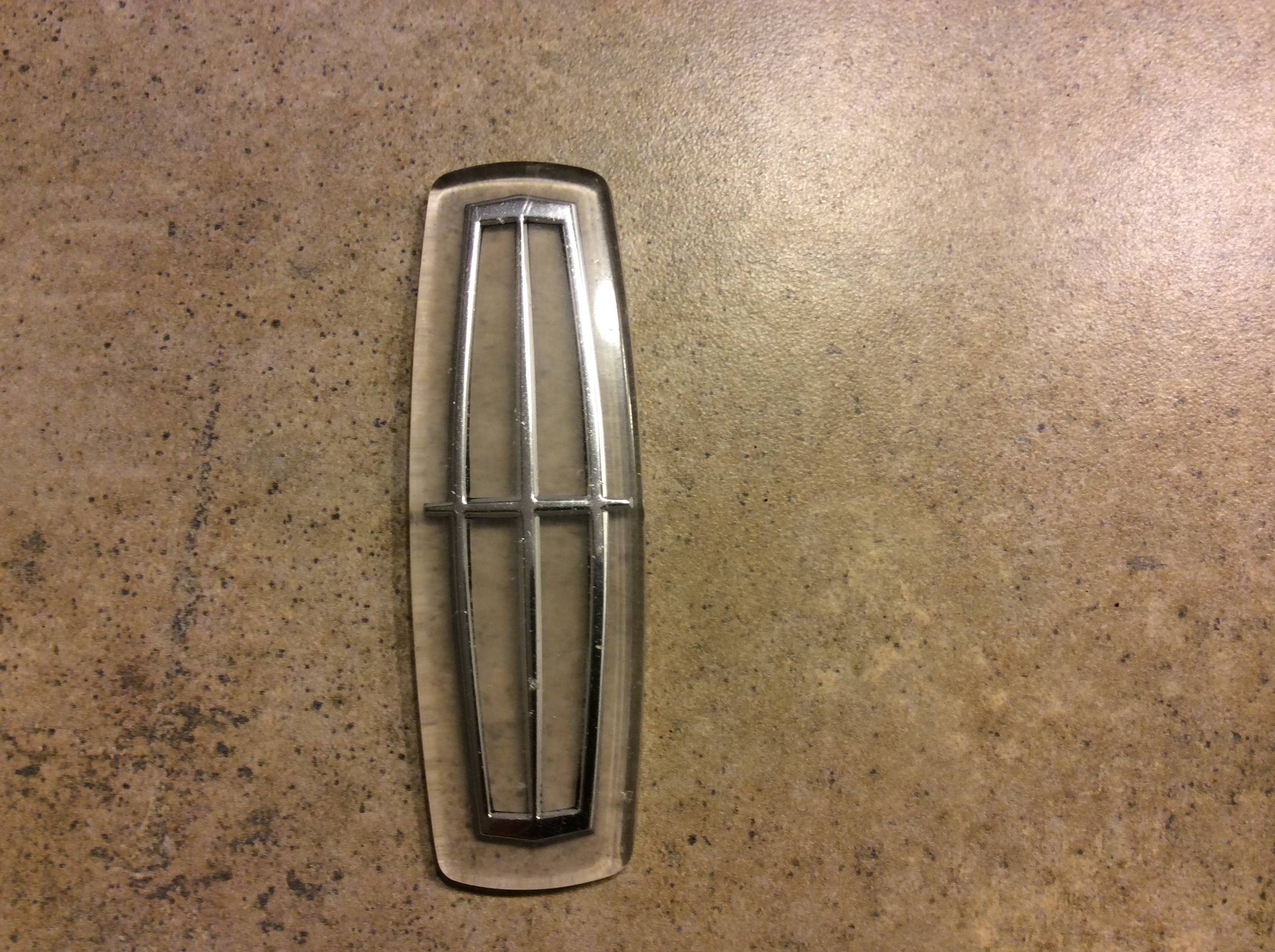

    400 grit sandpaper to sand off black backing.

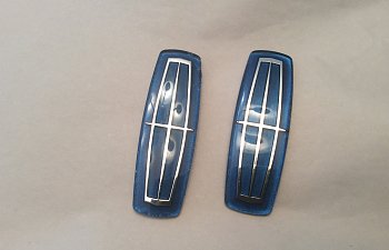

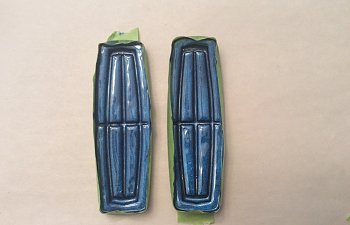

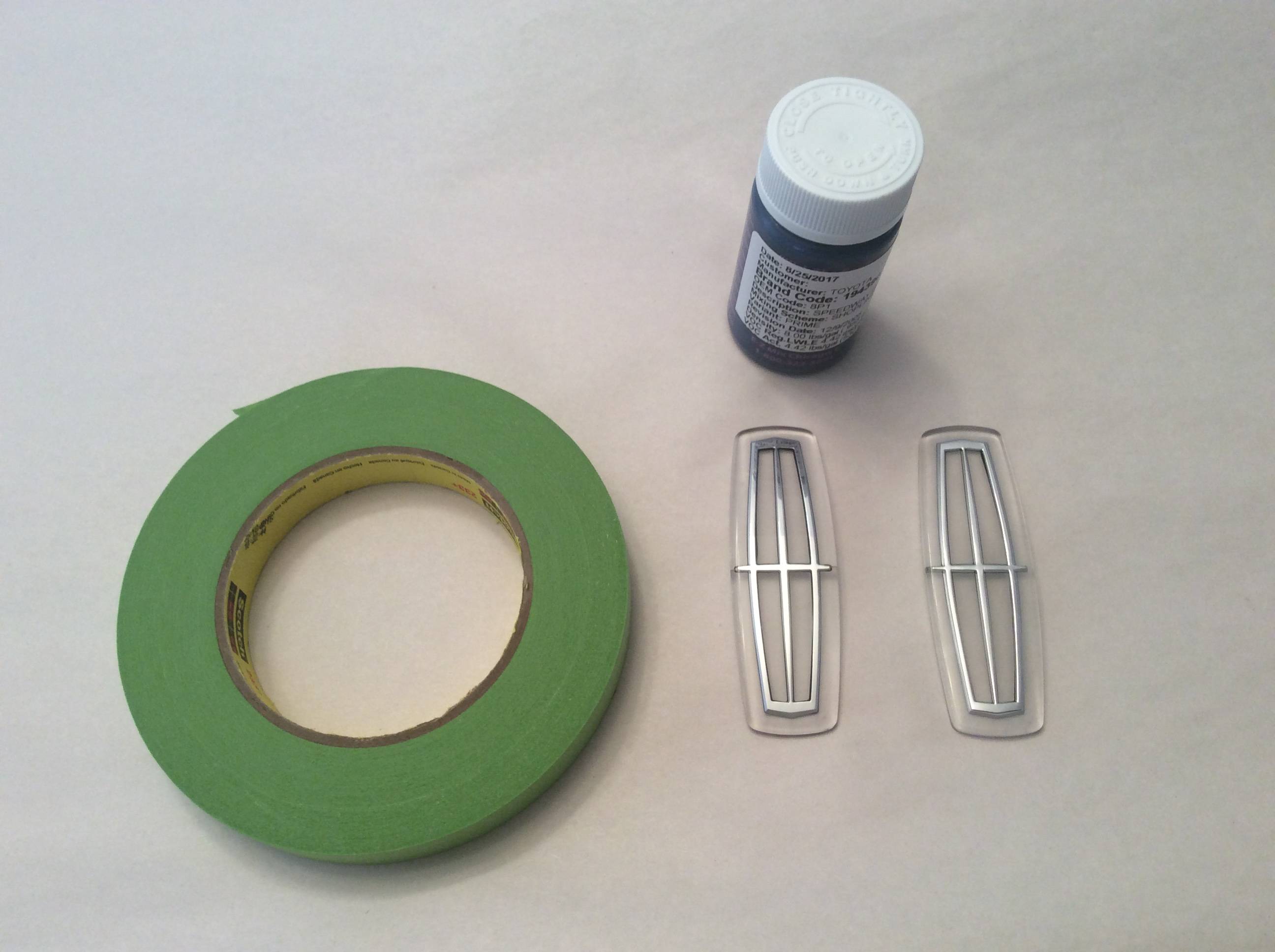

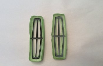

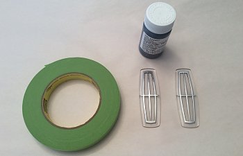

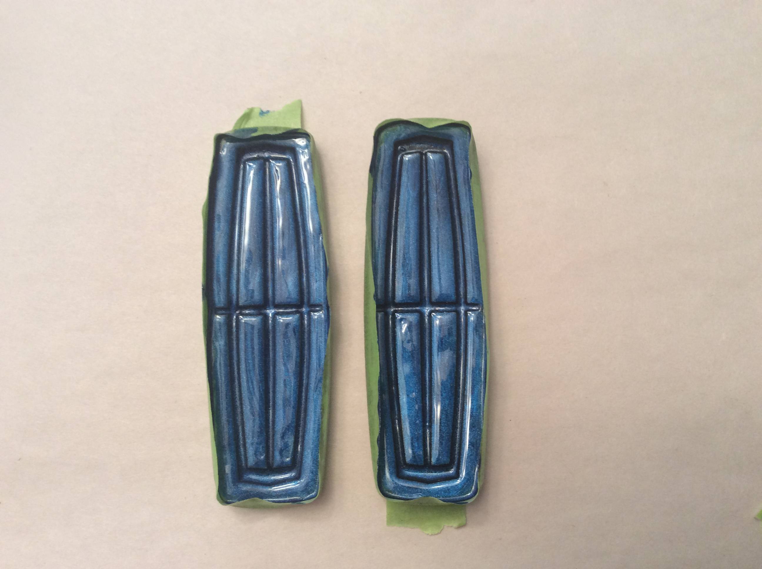

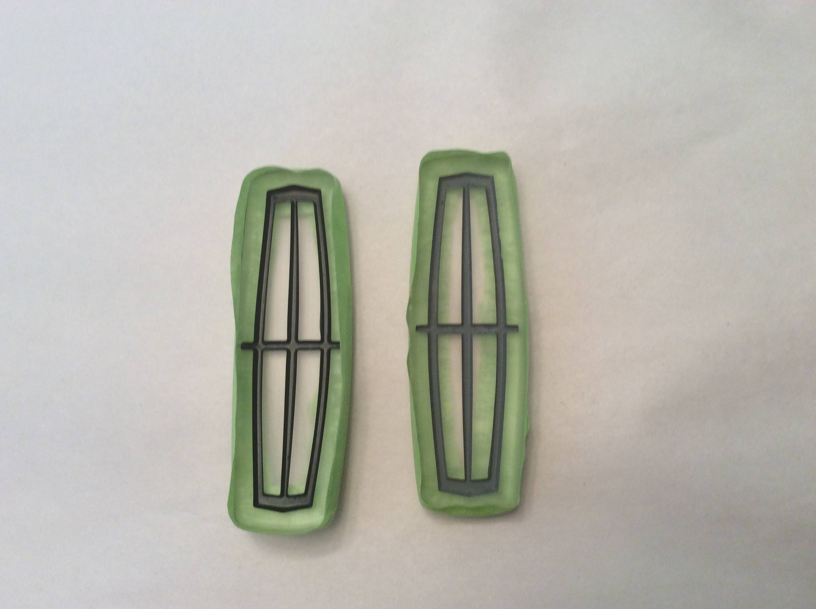

    Tape off edges and front.

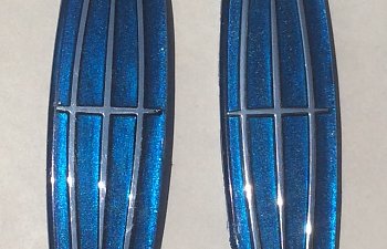

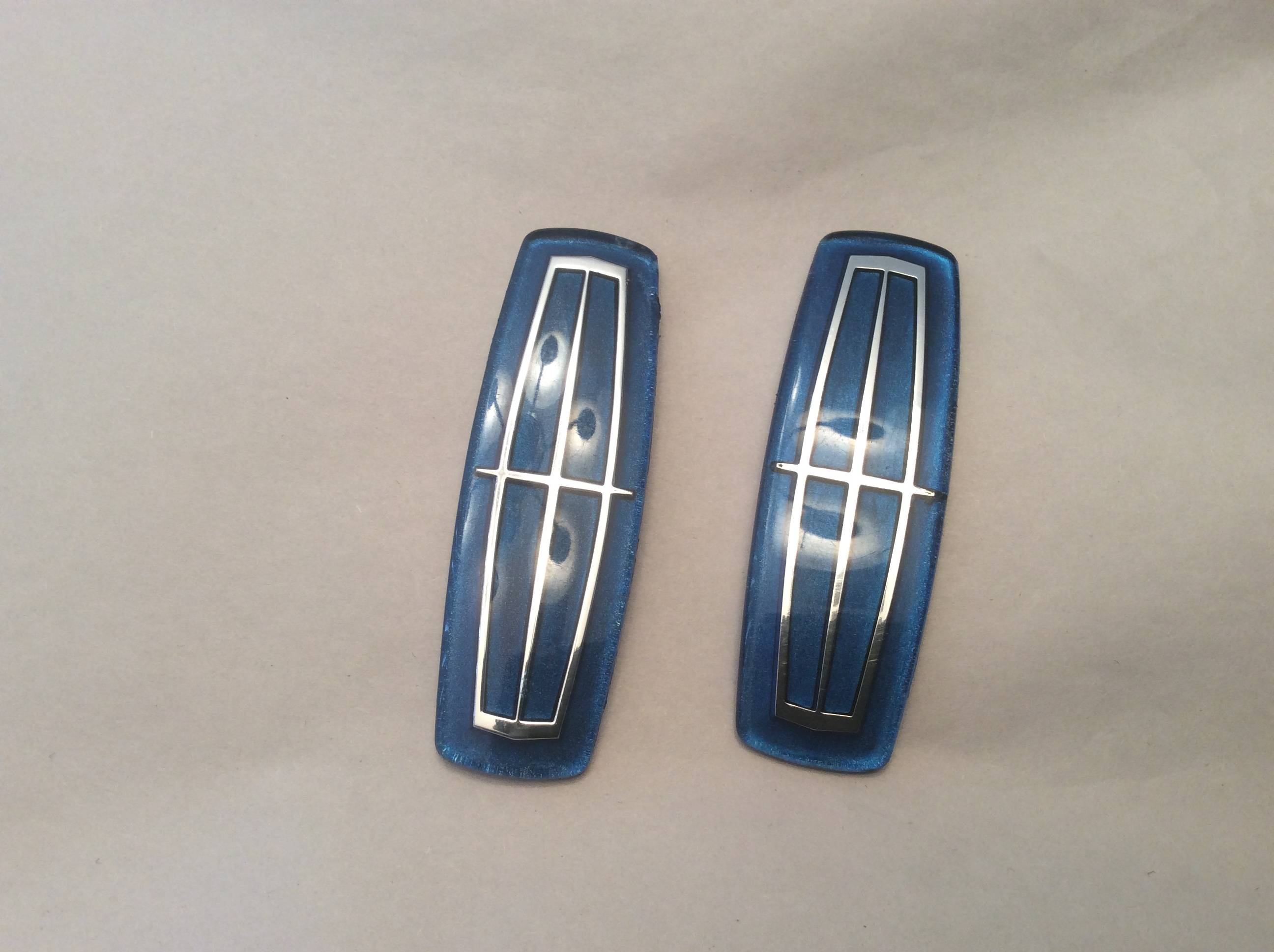

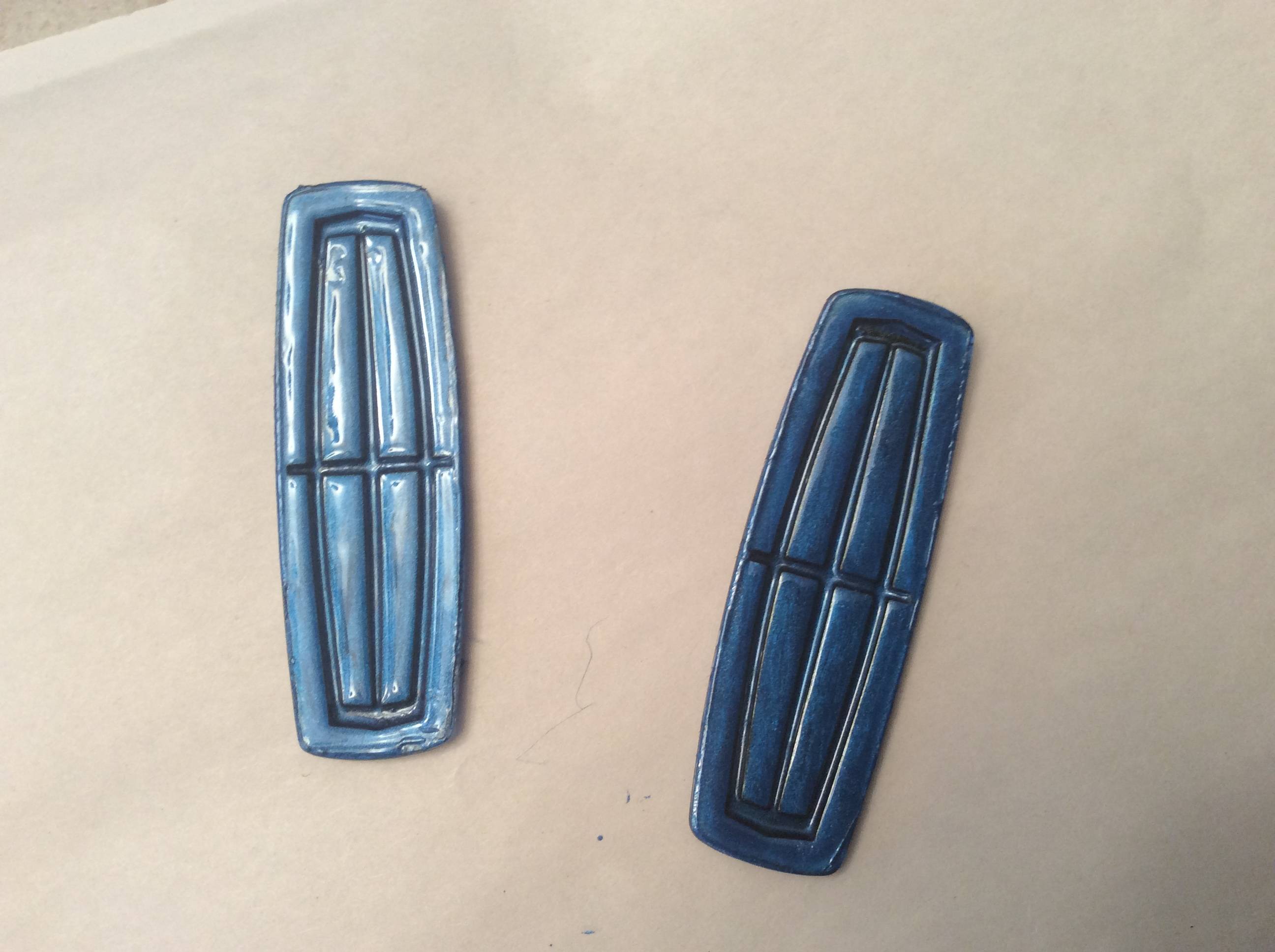

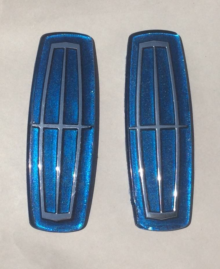

    Paint. You can use fingernail polish or get a small bottle of OEM touch up.

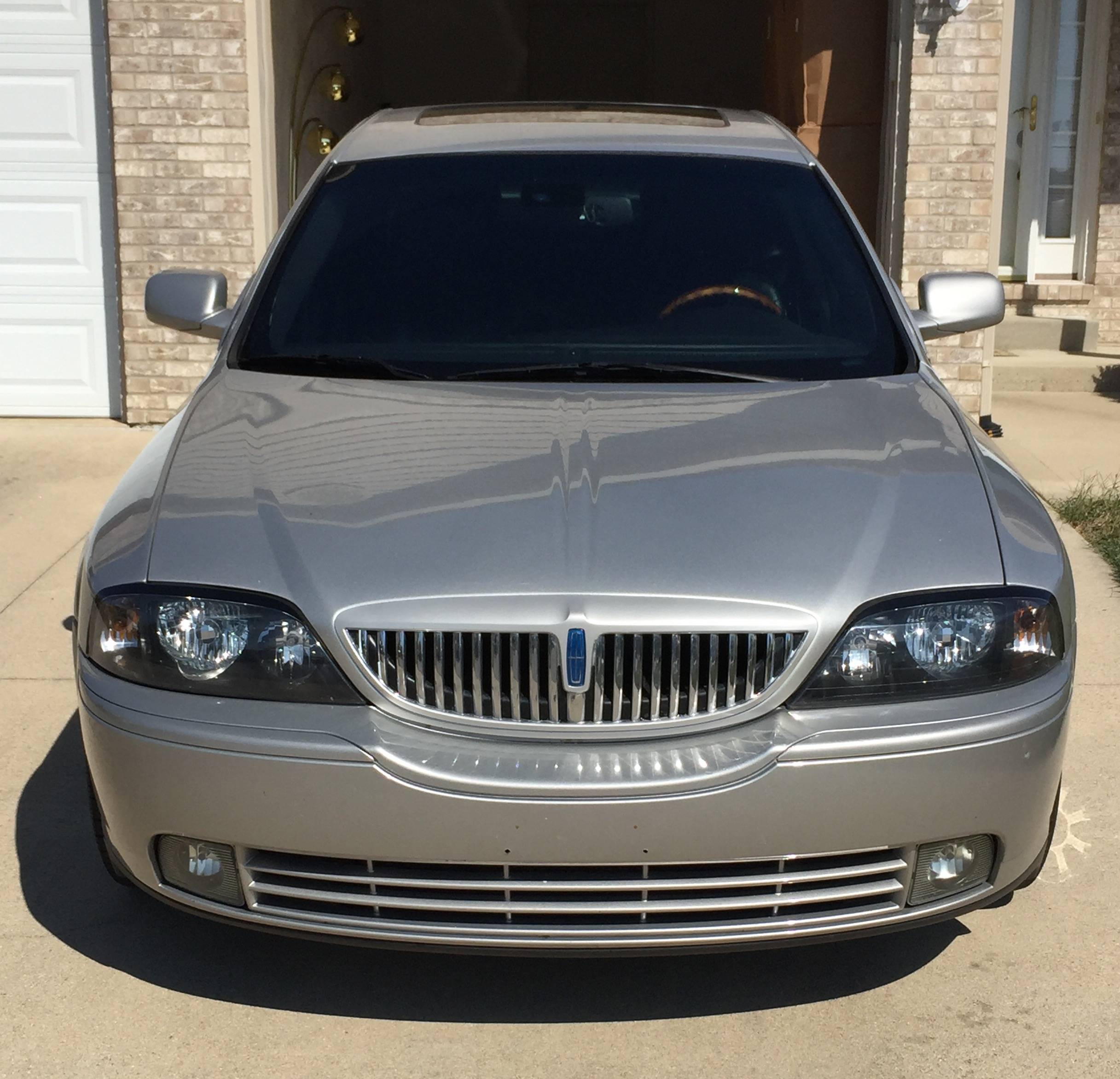

    Install with double sided 3M tape.
