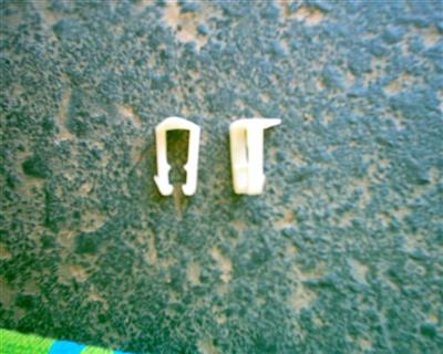

You will also see there are two clips that come with the filter, do not toss these away as you will need them. (See photo)

6.) With your screw driver, un-tighten the metal adjustable band that holds the filter inside the bracket. You can see it on the left in Pic 5. Take the screwdriver and pry out the existing plastic clips (Pic 4) that is holding the filter onto the fuel line. Be careful not to break the fuel hose housing. It may take a few minutes of wriggling the old ones out as you can see from Pic 4 that there are teeth holding the plastic clips in.
