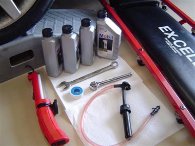

Items Required:

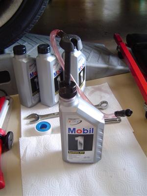

  • -- Four quarts of Dextron III Automatic Transmission Fluid (for mine I used Mobil1 ATF).
  • -- Fluid pump (make sure the threads are big enough for the Mobil1 bottle) or a suction gun would also work well
  • -- Oil drain pan
  • -- Set of Rhino ramps (preferable) or jack stands and hydraulic jack
  • -- 7/8" open end wrench
  • -- 3/8" Socket - ratchet
  • -- Roll of teflon tape
  • -- Creeper
  • -- Trouble light

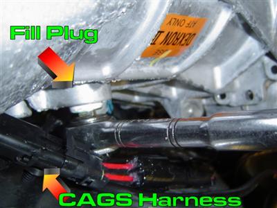

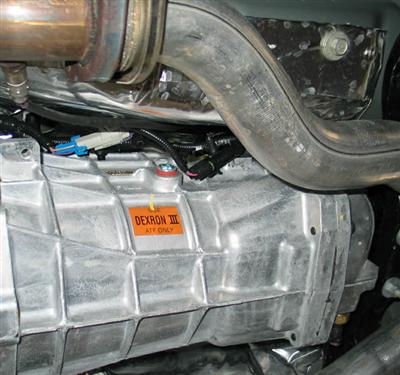

3. With the Cadillac CTS-V safely supported, remove the fill plug on the driver's side of the transmission with the 3/8" ratchet. The fill plug is half-way up the side of the transmission, near the orange "Use Dextron III ATF Only" sticker and CAGS harness.

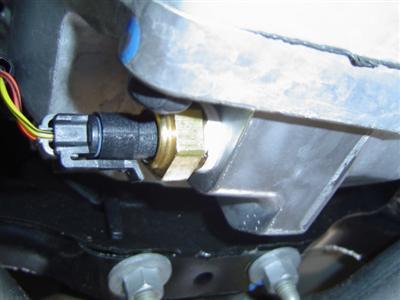

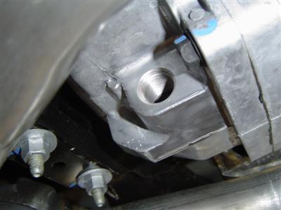

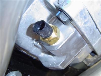

4. On the passenger side of the Cadillac CTS-V, locate the transmission temperature sensor. It is located on the right hand side at the lower rear of the transmission. Next, disconnect the transmission temperature sensor harness and place the end of the harness behind the transmission's serial number tag to prevent the harness from being melted on the hot exhaust pipe.

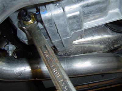

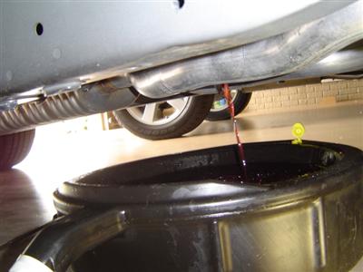

5. Slide the oil drain pan under the V and with the 7/8" wrench, remove the temperature sensor.
NOTE: Caution! Hot oil will come out quickly and also splash on the passenger side exhaust pipe!

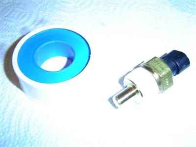

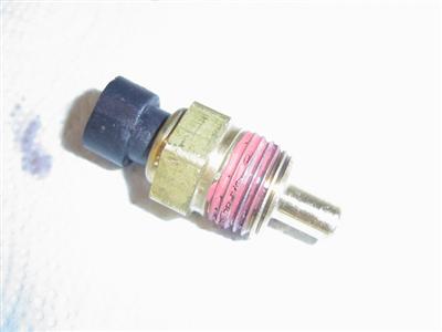

6. While the fluid is draining, clean up the temperature sensor.

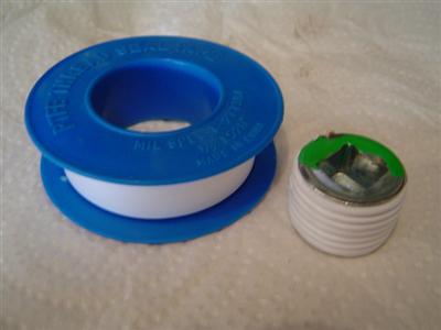

7. Apply several wraps of teflon tape around the threads of the sensor. Make sure to wrap it the correct direction. Suggest holding the tape in your left hand, the sensor in your right. Place the tape on top of the sensor threads and rotate the sensor clockwise with your right hand. This will put the tape on in the same direction as the threads are cut.

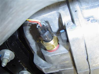

9. Thread in the temperature sensor and tighten until it is just snug with the 7/8" wrench.
10. Reconnect the temperature sensor harness.
11. Clean the fill plug and wrap with teflon tape, similar to step 7.

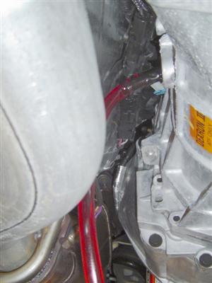

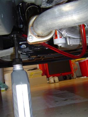

12. Use a fluid pump (or a suction gun) to pump the fluid into the fill hole on the driver's side.

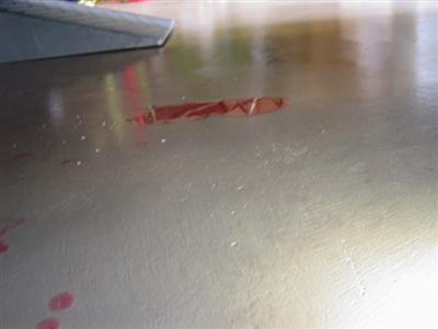

13. Fill the transmission more slowly when you get about half way through your 4th quart of fluid. Continue to fill until fluid begins to run out of the fill hole. Here's the puddle of fluid I had on the floor after "knowing" it was full.
14. Insert the plug and tighten until just snug with the 3/8" ratchet.

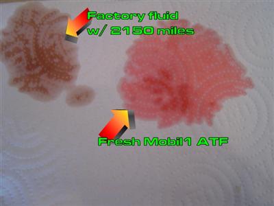

16. Here's the comparison in color between the factory fill and the Mobil1. Hate to see what this would look like after 100,000 miles since GM says it is "filled for life."
T he technical specialists / guru's on the Z6 forum advise waiting until 5000 miles before switching to *synthetic* tranny fluid, to make sure the syncho's are fully broken-in.

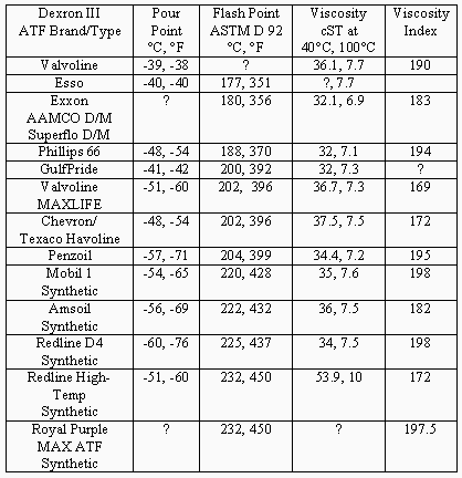

H ere are some Fluid Specifications:
Also: And here is a "zoomed-out" pic showing both fill (above Dextron III sticker) and drain plugs (lower right of pic). Note the exposed threads on the plugs (factory orange thread compound)... as posted, "tighten until snug"... no need to waste on the plugs.
