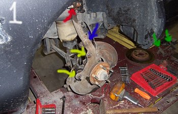

By: 94M5 The Following is a step by step instruction to R&I the lower ball joints on the Mark VIII. Hopefully the pictures will explain everything that I may fail to put in here, but if not, contact me OR joey, and we’ll get you the correct info, and then update the install guide. I am NOT a...
