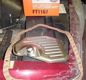

Tools and parts you will need: Safety glasses Note: wear safety glasses while under the vehicle for eye protection as there's lots of dirt and grime under there just waiting to drop into your eyes. The new filter and gasket. I used the filter brand Fram model FT1167. The fit was good.

Here's a picture of the Ford 4R70W transmission pan with the gasket sitting on top. The OE gasket is re-usable and is stamped as such shown by the red arrow on the right side of the picture below. Notice the grey colour donut magnet shown by the arrow on the top left of the picture.
The transmission with the pan off.
Using rags or paper towels and solvent clean the interior of the pan and carefully remove the sludge from the pan magnet at the bottom. Clean the edges of the transmission that the gasket touches. A rag or your scraper might be needed to get any rubber that's stuck on. This surface must be clean to allow a good seal when you put the transmission back together. Clean out the transmission pan and remove all remaining parts of the rubber gasket around its edges. There is a metallic film on most of the pan surfaces that will wipe off. If you find a little plastic plug with a rubber o-ring, don't worry, this was in the dipstick tube while the engine was assembled on the assembly line and falls into the transmission pan. It's not a broken or missing part! Discard it or keep it as a souvenier.
The clean transmission pan. Don't lose the round magnet that's in the bottom of the pan! It goes on the little bump and it collects any metal shavings that might be floating in your fluid. Take it out and make sure it is clean.
