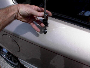

With needle nose pliers, insert nose into slots on nut at top of antenna base.
Lincoln Town Car
Remove nut and base from antenna mast. Turn car stereo on, remove antenna mast and nylon cable by pulling from power motor assembly.

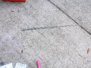

Lincoln Town Car*NOTE - Measure length of new antenna mast against old antenna mast. (In this picture, there is no nylon cable attached to mast). If they match in length, insert new mast and turn stereo off. Feed nylon cable into motor. Install mast base and nut. If they do not match in length continue with instructions.

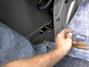

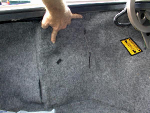

Remove two plastic side panel tabs from panel.
Lincoln Town Car
Pull side panel from car, feeding manual gas flap release through panel.

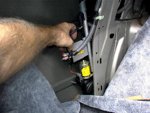

Disconnect antenna cable and connectors from power antenna assembly. Remove bolts securing power antenna motor assembly.
Lincoln Town Car

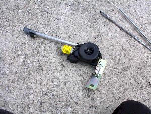

Place antenna motor assembly on flat ground for disassembly.
Lincoln Town Car

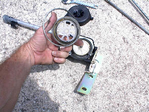

Remove cover from power antenna motor assembly.
Lincoln Town Car

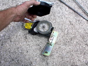

Remove gear assembly.
Remove nylon cable from cover.
Inspect power assembly for debris and pieces of nylon cable.
