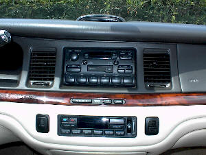

The Lincoln Town Car stereo functions a bit differently than other conventiona stereos. The interface that is built into the dash of the Lincoln Town Car is only a tape player, display and control unit. The steering wheel controls are also interfaced here.

In order to change the radio you will need to interface power and speaker connections to the new radio. The power connections can be found behind the in-dash controller. Constant power, ground, illumination dimmer and key turn on. All speaker connections and antenna connection can be found the trunk in the radio controller unit.

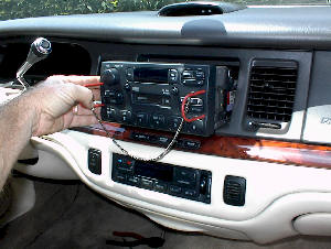

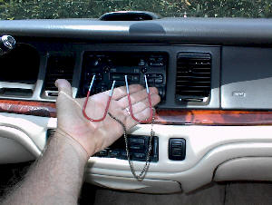

Take your ford keys insert them into the display on each side slowly at the very first click, pull apart and out. The radio controller is now removed from your Lincoln Town Car.
