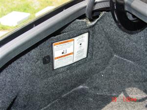

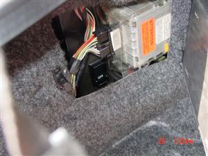

1. Turn off the air ride suspension switch, located in the truck on driver's side.

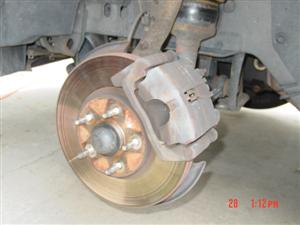

7. Now, inspect the brake system. Look for leaks, cracking lines, or anything that looks like its going to fail soon. I had no such problems.
Lincoln Mark VIII Brake

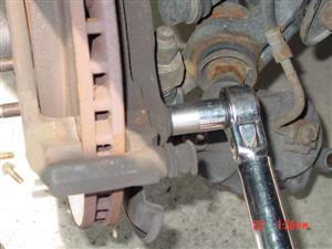

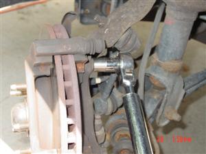

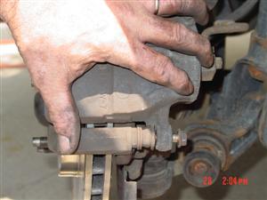

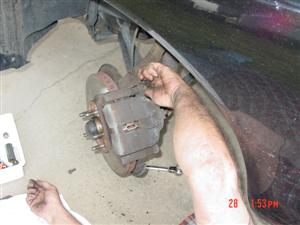

8. Remove the two bolts on the rear of the caliper assembly, and remove the caliper assembly.

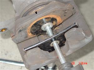

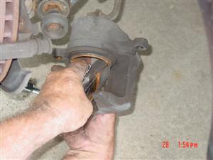

9. Remove the old pads. Raise the hood and open the cap on the brake fluid reservior so as to relieve the fluid pressure. Now place your caliper compression tool into the caliper using one of the old brake pads as a brace and compress the caliper. This is done to make room for the new, thicker pads. I like to now tie the caliper assembly to a part of the suspension to keep pressure off of the brake lines.
Lincoln Mark VIII Brake Caliper Lincoln Mark VIII Brake Caliper

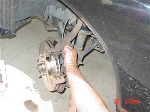

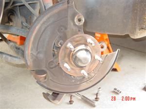

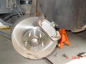

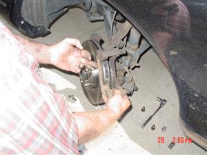

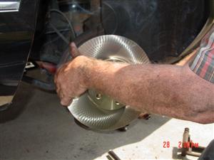

10. Now remove the caliper cradle by removing the two bolts on the rear of the cradle. (this is only necessary in the 1993 - 1996 models, 1997 - 1998 models have a one piece assembly) One your do this the rotor will slip right off. Either replace the old rotor with a new one or take the old one to be turned and then replace it.
Lincoln Mark VIII Brake Lincoln Mark VIII Brake
Lincoln Mark VIII Brake Lincoln Mark VIII Brake Rotor

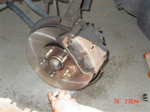

11. Now replace the caliper cradle and replace the bolts that secure it. (this is only necessary in the 1993 - 1996 models, 1997 - 1998 models have a one piece assembly)
12. Place your new brake pads in place in the cradle and then replace the caliper over them securing the caliper in the proper position. (this is only necessary in the 1993 - 1996 models, 1997 - 1998 models have a one piece assembly and you have to place the pads in the caliper as you slide the caliper down onto the rotor) Remove the rope you used to tie the caliper up.

Remove the jack stands and lower the car. Turn your air ride suspension back on. Close the cap on the brake fluid reservior, adding fluid if necessary.
