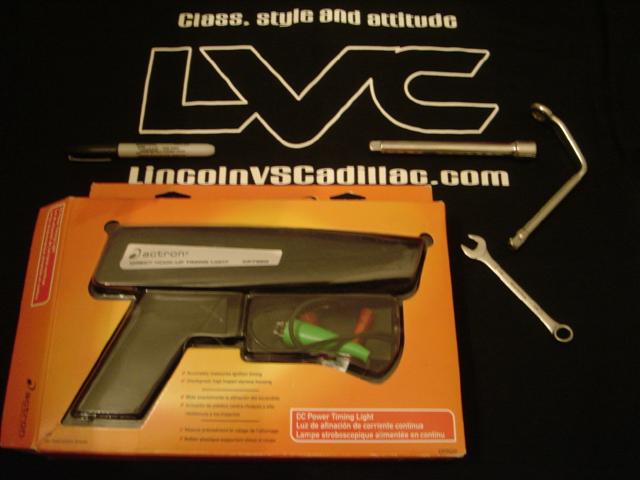

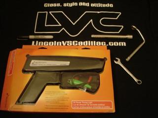

1. You’ll need a timing light and a ½” wrench. You may need to buy one that is for getting to your distributor nut. This can be found at any auto parts store. I also needed an extension. So, it would reach to the nut. About a four (4”) inch extension would be more then enough. I also use a small wrench on top to help turn the wrench hooked to the distributor base. About 10mm, I believe.
2. You will want to mark with some chalk on the crankshaft balancer at 14 degrees if you are advancing your timing. If you are not advancing your timing. 10 degrees is where its suppose to be.

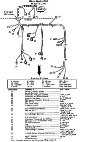

3. Now you will have to remove the spout connector found hanging from the single wire attached to the distributor wire harness.

7. You will now want to reconnect the spout connector. If this is not done, the computer will not allow for maximum timing and fuel curve.
