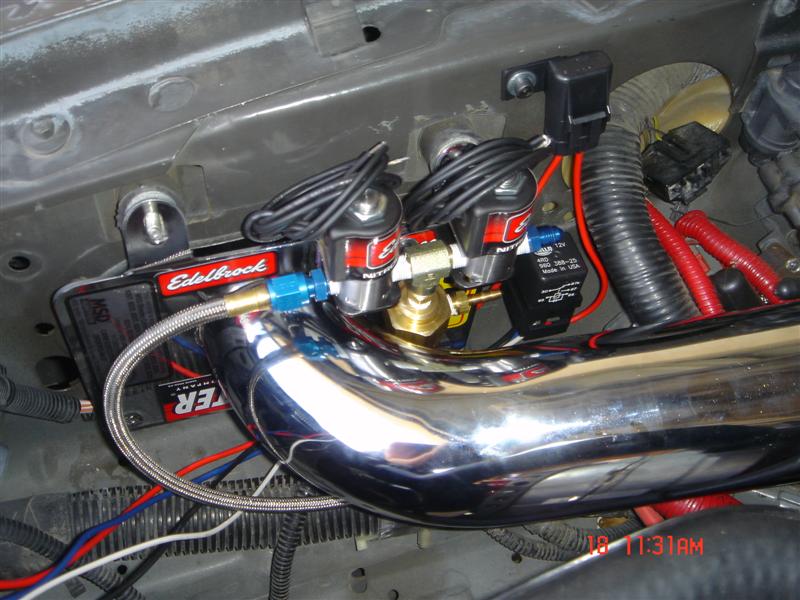

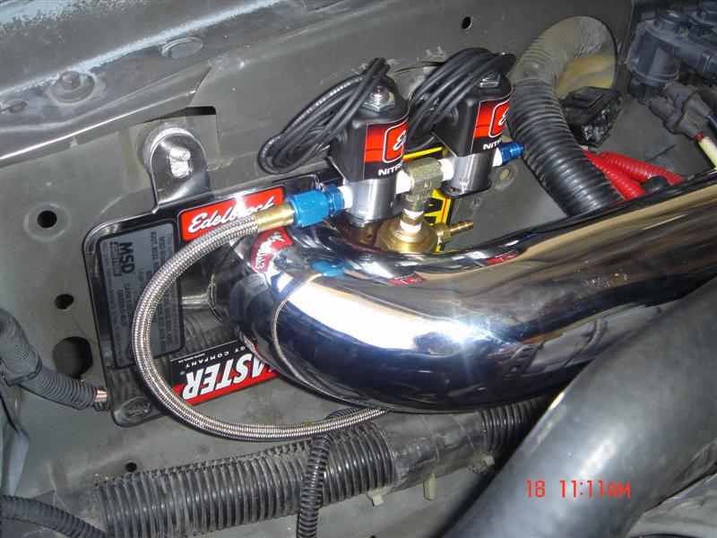

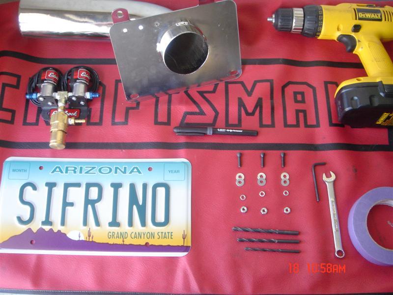

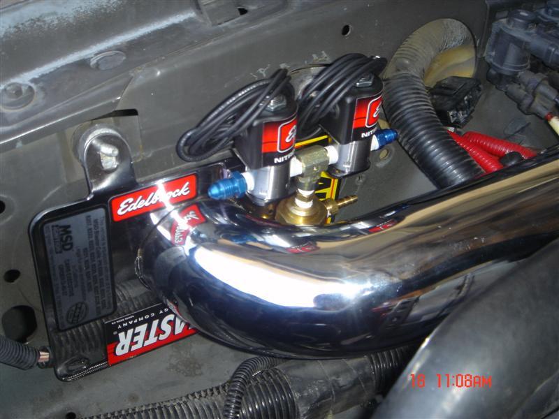

My solenoids have
already been put together and I was looking and looking for a place to
mount them. I could not find a spot that I really wanted to mount them.
After just looking at the engine bay for several days. I decided to mount
them on my Mac cold air induction. That takes air from the fender. If
you have seen this intake before. You will notice that there is a very
good flat piece. That goes up against the inside engine bay, to cover
the whole that goes to the fender.

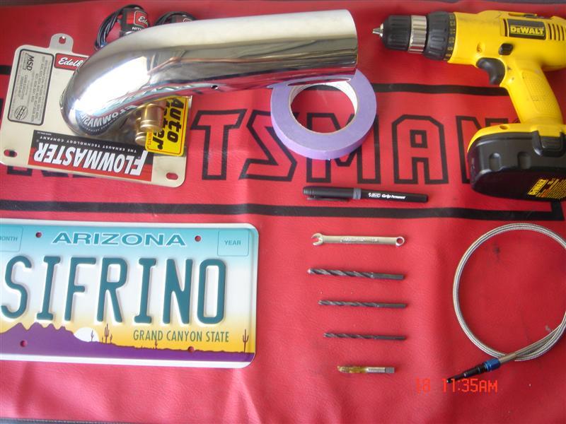

So, I decided I would
mount my solenoids there. I took the mounting bracket that came with the
nitrous kit and put it up against the fender intake. I have decided to
mount it on the far corner on the panel. Before I started drilling. I
took masking tape and put it on both sides of the intake panel. The reason
I used masking tape is so the chrome would not chip and it is also known
to make the edges clean after you drill through metal. I put the mounting
bracket back onto the intake and marked my holes with a marker.
I started with a 9/64"
drill bit. After I made my holes with that bit. I went to the next bit
and the next one. Till I got to 7/32" drill bit. That was my final
bit. I used about two sizes between them bits. Reason being, it's just
what I do. It makes for cleaner holes. You have to go to the Hardware
Store for your bolts, washers, etc. They do not come with the kit. I made
my holes a little bit bigger then the bolts I used.

Three (3) Black Hex Bolts 10x1/4" (Size/Length)
Three (6) Washers 10 (Size)
Three (3) Lockers 10 (Size)
Three (3) Nuts 10 (Size)

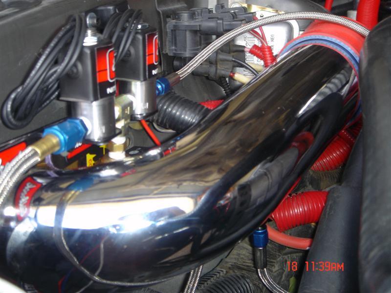

After I got everything
I needed at the store along with some Mtn. Dew (OS1). It was time to mount
it up. I first mounted the solenoids to the bracket. (Just easier on you
to do it now.) Then I put it up against my mounting holes. I'm mounting
my bracket with three bolts. Because the bracket allows me to. Two bolts
should be enough. (I'm safe then sorry.) I went with one hex bolt, one
washer, bracket, intake plate, one washer, one lock washer, and then bolt.
(In that order) I just tightened it down till the lock washer was flat.
(That was for all three) After you have done your first step. Step back,
take a look at what you did. Get a Mtn. Dew! Take pride, that you have
done a great job!

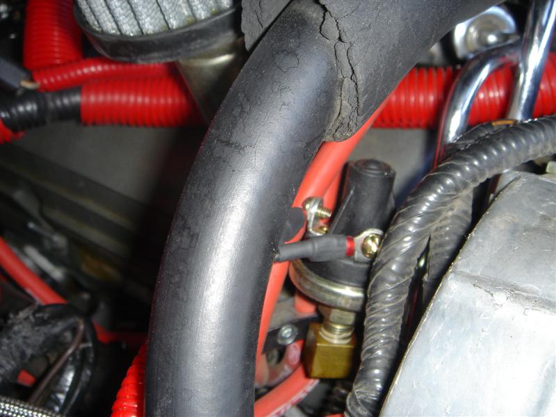

My first thought was.

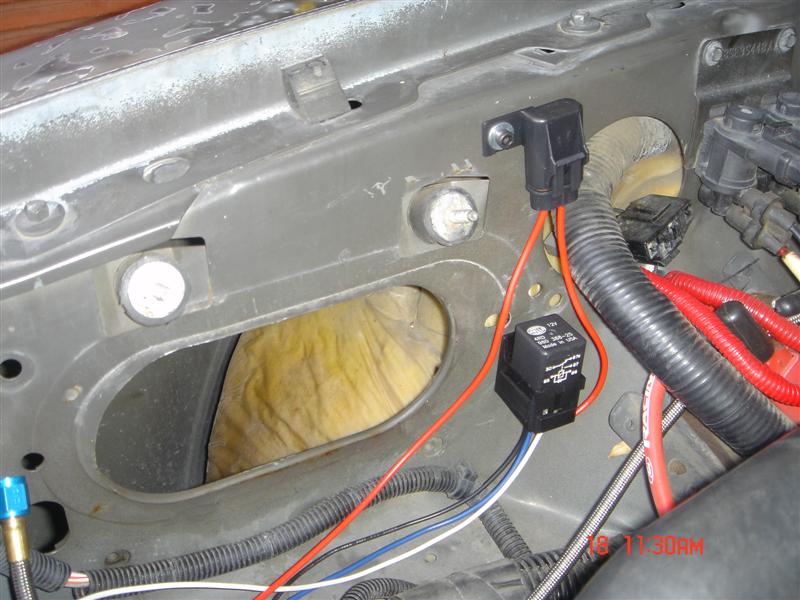

Where am I going to mount the 30 amp relay and fuse holder. I wanted to
put them where I can get to them easily. Just in case. (Remember, better
safe then sorry.) I found a great spot near the solenoids. And there were
a bunch of holes already there. So, I decided to use two of them. (This
is great, because you do not have to drill into the body and expose metal
for rust.) Taking some drill bits. I put one in each hole. To see what
they're sizes are. So, I can go buy some bolts, etc. My sizes ending up
being ¼" and 7/32". I got my bolts a little bit smaller
then the holes. So, I can use nuts. Now it is time for shopping!

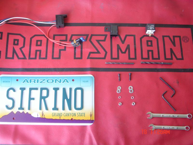

Shopping
list;
One (1) Hex Bolt 10
One (1) Hex Bolt 8
Two (2) Washers 10
Two (2) Washers 8
One (1) Locker 10
One (1) Locker 8
One (1) Nut 10
One (1) Nut 8

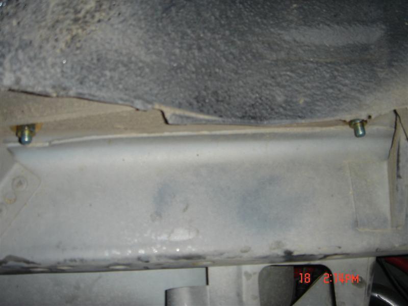

I needed at the store. Along with some Mtn. Dew. (OS1, by now I ran out.)
It was time to mount them. Here is where it paid off to mount my wire
harness near the solenoids. As you can remember I mounted my solenoids
on my intake plate. Well, I can take off the intake and I am able to reach
through to put the nuts on. If you can not put nuts on. You will have
to use sheet metal screws. I really like to use nuts and lockers. It makes
for a very tight fit. That should last forever! Well, I went with one
hex bolt, one washer, harness/fuse holder, sheet metal/body, one washer,
one locker, and one bolt. (In that order) I did this to both of them.

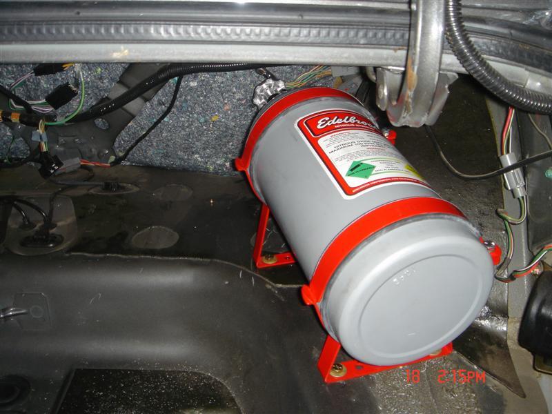

Now before you hop
in the trunk to install your Edelbrock nitrous bottle. Get your bottle
and brackets. Put your brackets on your bottle. (Where you want them.)
Tighten everything down. If you are going to run a bottle heater. The
brackets will have to be so far apart. I think it is 8 ½"
from bracket to bracket. You will have to have at least 1" from your
first bracket to the bottom of the bottle. (Do not go any closer to the
bottom of the bottle.)
Now here are some
of the things your should have before you hop in. Bottle with brackets
installed, marker, masking tape. Now hop in and put your nitrous bottle
where your nitrous line can reach. Before marking the wholes it is always
good to use masking tape when drilling through metal. Put the tape down.
But your bottle back where you want it. Now mark your holes. Get out of
the trunk. Take everything with you. Now you will need a drill and drill
bits.
But it isn't that
easy. It's measuring and measuring. Because you need to bolt it from the
bottom. I took off my rear tire and measured and measured. The frame goes
right down my bolt holes. If you drill into the frame you will not be
able to bolt it. So, make your holes count! After you have the holes drilled
with a 3/8" drill bit. It is shopping time. Remember you will need
grade 8 bolts and etc. I used one size smaller bolts/etc then the 3/8"
drill bit. . .
Shopping
List:
Four (4) Grade 8 Bolts
Eight (8) Grade 8 Washers
Four (4) Grade 8 Nuts
Now all you have to
do is. Stick the bolts down from the top. My order was one bolt, one washer,
bottle bracket, floor board, one washer, one nut. After you have done
this. Take a good break. I know my hands took a beating trying to get
them nuts screwed on. You will need a friend to help you out. Someone
has to hold the top bolt while you torque the nut down. I had my very
helpful wife Dannielle help me out.

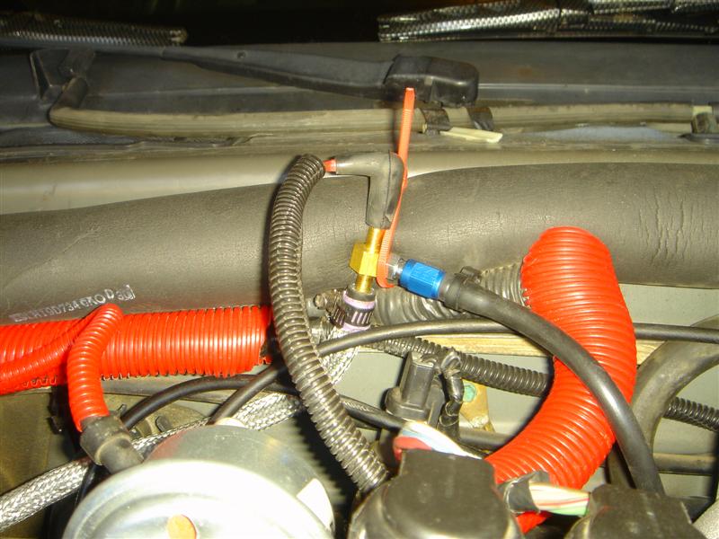

My nitrous instructions
said to drill a 7/16" hole for my nozzle. I had a few places I wanted
to put the nozzle already. I really wanted to put it into my Cobra Manifold.
But now knowing. You have to have it before the throttle body. Because
that is where my nitrous switch is located. (At W.O.T. my nitrous
will spray.) So, you have to have it before your switch so the nitrous
can shut down in time.

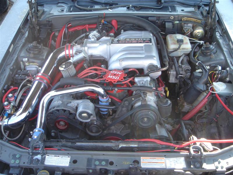

So, after I have already
mounted my solenoids on my fender part of the intake. I thought I would
just mount my nozzle on that same piece. Just so, all the nitrous components
are just messing with one piece. Just incase I decide I do not want the
nitrous anymore.
I choose to mount
my nozzle on the bottom part on my intake pipe. I do not want a direct
view of the nozzle. I also, wanted it to look cleaner. Plus, there is
plenty of room under there for the nozzle to stick out.
Now I first put the
intake back in the car and choose a spot. Putting my fingure on the spot
I want it. I took the intake out. Then put masking tape where I was going
to drill. I then marked with marker on the masking tape. Now it is time
to drill. But just wait. I put the intake tube back in the car and checked
where I put the masking take. I made sure that it was in the spot I wanted,
still. (You never know, better safe then sorry.) The first drill bit I
used was 13/64". Then I used one between that and ¼"
for my final whole. Now that I have my hole drilled straight and true.
It
was time to tap the whole. (Put threads in.) They should have given you

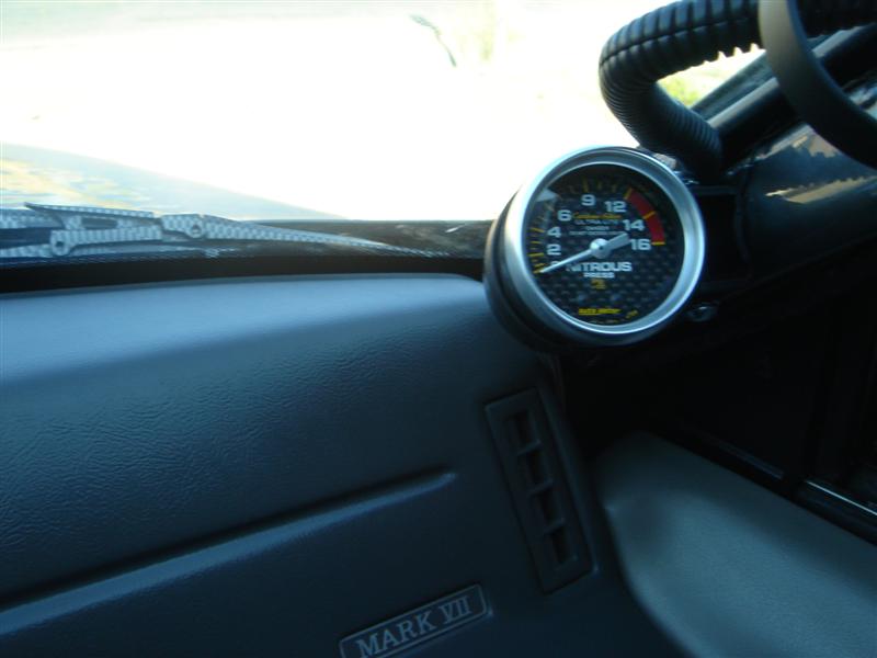

In this step we will
get our feet wet with electrical. This being the nitrous gauge. I used
a Autometer 4728 mechanical gauge. With a Autometer carbon fiber gauge
pod 2121. I also needed some nitrous line. With 16 gauge wire and connectors.
I used male and female connectors. So, I can easily remove the gauge.
I
started with mounting my gauge cup. I mounted mine on the passenger a-pillar.
You can mount it where ever you would like. Its end less. . . After I
mounted the cup. I got my line and put it through the cups rear. Then
screwed it onto the back of the gauge. When putting the gauge in. You
will have to have the female connectors already on the rear of the gauge.
(For the lighting.) After you have put the gauge in the cup. You will
have to make up extra electrical wire to reach where a power source is.
Make sure it is a source where there is no power when the key is not on
the ON position. After you have hooked your electrical wires up and everything
is tied up with zip ties.
Now it is the time
to run your nitrous gauge line to the bottle. Or you can have it hooked
up by the solenoids. I choose to hook it up on the bottle. Instead of
making a hole in the fire wall. . . Do not put the trim pieces over the
nitrous line. Because you will have to check the line for leaks when you
arm your system for the first time. (Soapy water and a brush.) Now that
you have finished your gauge install. It’s on to the next step!

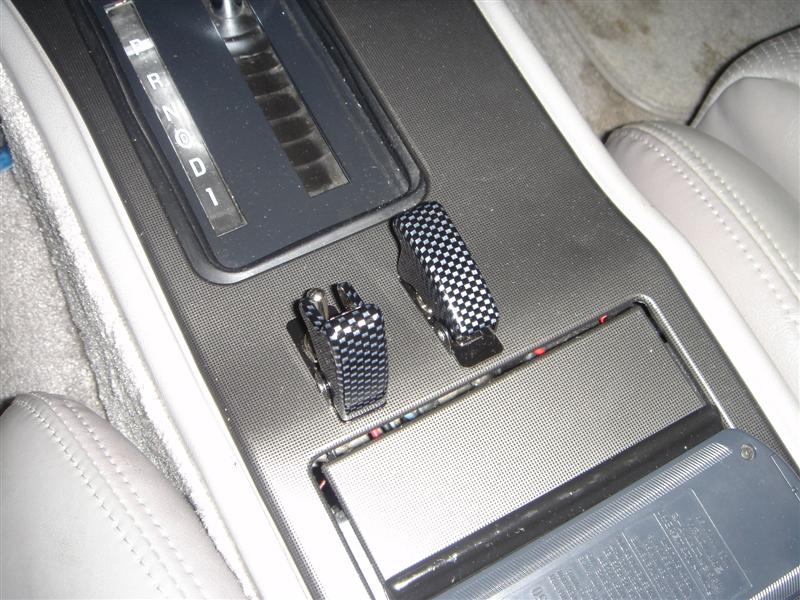

Step Seven:
This step should
be very simple. It is mounting your activation switch or Go Baby Go Switch!
Now I have a switch that sprays the nitrous at full throttle. If you just
have a button. It will be even easier. But I will not cover that! This
is about installing the Edelbrock nitrous kit.

This step is too
easy to make a step. But it is an important one. This will be mounting
your fuel regulator. You first have to take off the pressure restrictor
on the fuel rail. This is located by the intake tube going down the engine.
While you screw it
off. There may be fuel in the rail. So, hold a rag under it. So, it will
not leak all over the engine. Now that you have gotten it off. You will
need to take the adapter piece that came with your regulator and screw
that on first. Once that is tight. Take your regulator and screw it on.
You are finished.

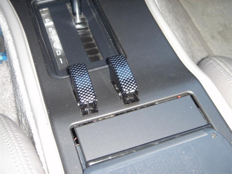

Step 10:
This
is you final step. This will include wiring and the switch to turn on
the nitrous. Let’s first find a stop to install the switch. I put
mine on the center console. I just popped. But you can put your switch
anywhere you want. Once you have mounted yours. Let’s start on the
wiring!
I first started with
the wires on the solenoids. The first one has two wires. One to the ground
the other to the harness. I cut them down to length and put some male/female
connectors on the wires. The second solenoid has two wires also. One goes
to the harness and the other goes to the fuel pressure switch that you
put on the fuel rail. On both solenoids, the one that goes to the harness.
You have to connect together and connect them to the blue wire coming
from the harness.

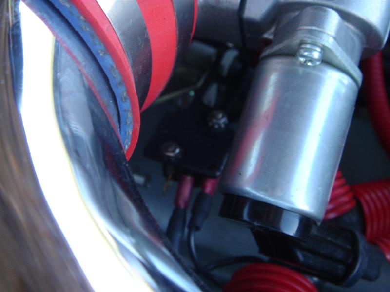

Now let’s wire
up the throttle switch. The black wire that comes from the harness has
to connect to the middle
opening of the switch. Now you have to put a ground on the opening that
is on the right side that is on the side of the switch.

Running the MAIN power line to the nitrous. It is a red wire coming from
the fuse holder that is part of the harness. Once you have wired that
up. You are now DONE! You may want to take all the wires away in loom
or something. Just make sure everything is tied up out of the way!
