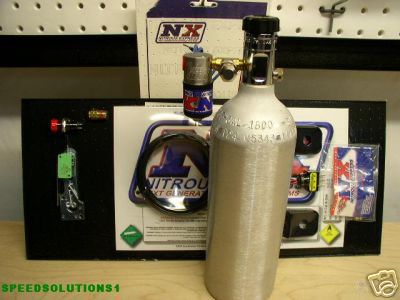

on installing the "Nitrous Here's the kit System comes with: Tools Needed: (what I used) Basic hand tools: Extra parts I needed: At least "5" Wire

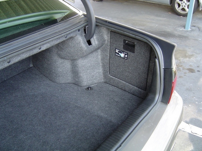

Ok, here's the car we'll be
working with. 1998 Cadillac Seville STS. I'm sure

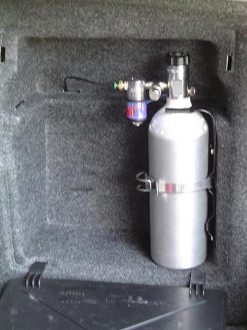

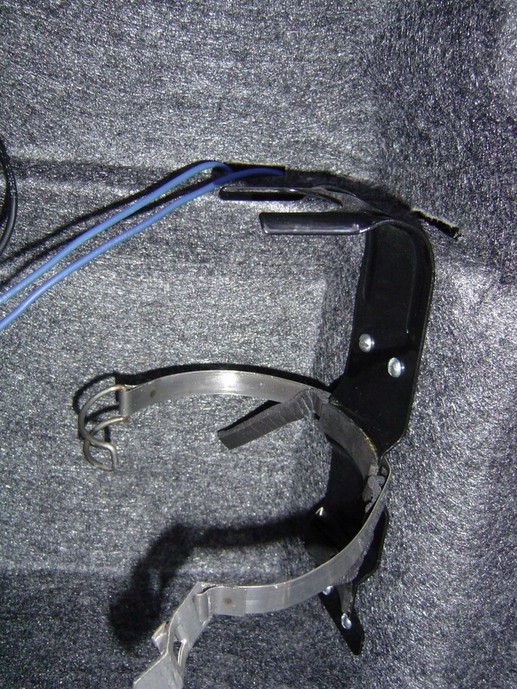

is any set order to do this in but they recomment the bottle first. Find
a HOWEVER - this is only a good location if you keep bottle in the car only at the track. In this location it could be very dangerous if you were hit in the rear by another car. I do NOT recommend driving on the streets with the bottle installed in this location.

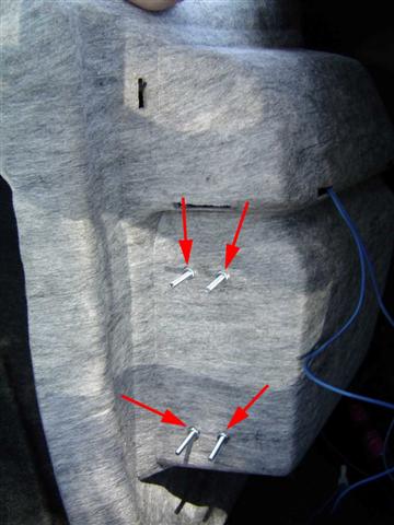

Here's how to mount the Bottle: The screws that I used came
with the extinguisher mount. I also purchased washers since I was mounting
Punch small holes with a knife

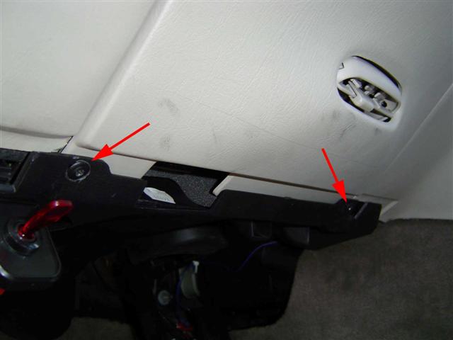

to get the screws Once you have that done you can move on to routing hose and wires. Well come back to the mounting later. Find Power: With all the wires in a Cadillac

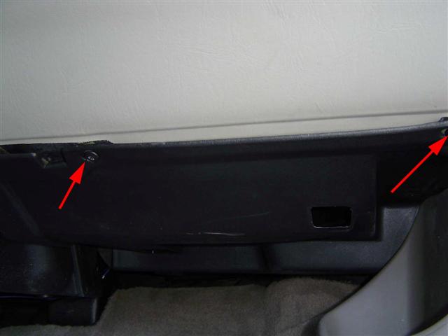

it can get pretty confusing to find the right one. Just use your test
First remove this panel and you'll see all the wires hang down. Splice your wire and make sure

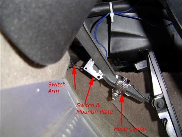

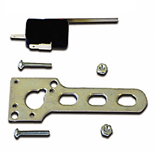

attached going to WOT(Wide open Throttle) switch. Although you don't Here's how to mount the WOT switch, if you decide to use it. I had to use a hose clamp to
attach it to the pedal. You can also attach it to the fire wall, but on
the The Mounting plate, screws,
and switch all come in the kit. Screw the switch to the plate and clamp
it on. Hard to do since
The wire coming from the switch

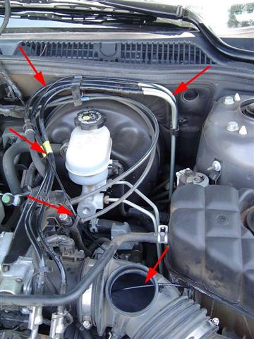

will go to this WOT switch. Another wire will go from this switch to the Now it's time to run the Nitrous

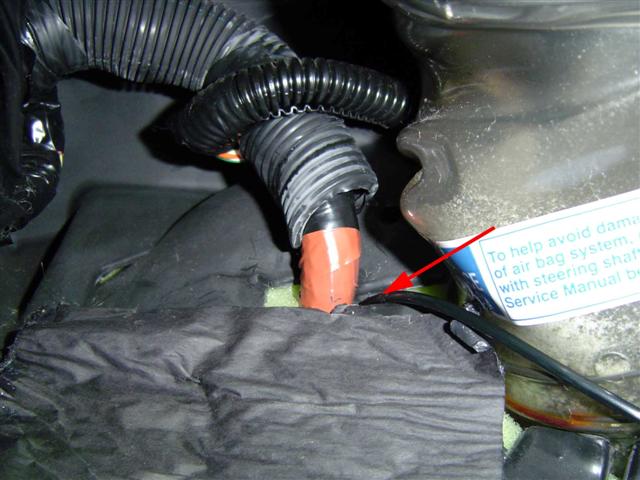

hose. You can leave both black panels off since the hose will be following Once through you can go back
inside and find the hose. Make sure to leave enough hose
to lead to your intake.

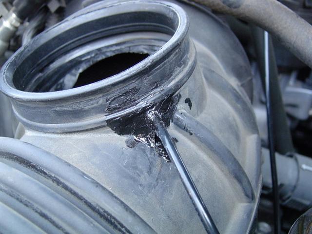

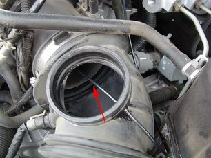

While your here you can cut
your hole into the intake Now run the hose along the
firewall with the wire. You should now have the Hose and wire located

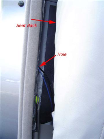

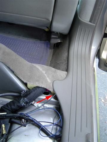

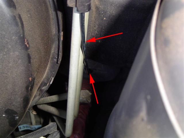

on the Now you can zip tie any extra hose or wire here and piece together the hose since it's not long enough. This next part can be tricky.
You'll need the wire hangar or something similar to run the hose and wire Once you get them through you
can go to the trunk and Now, connect the wire to one of the wires from the solenoid. Connect the other to ground.
