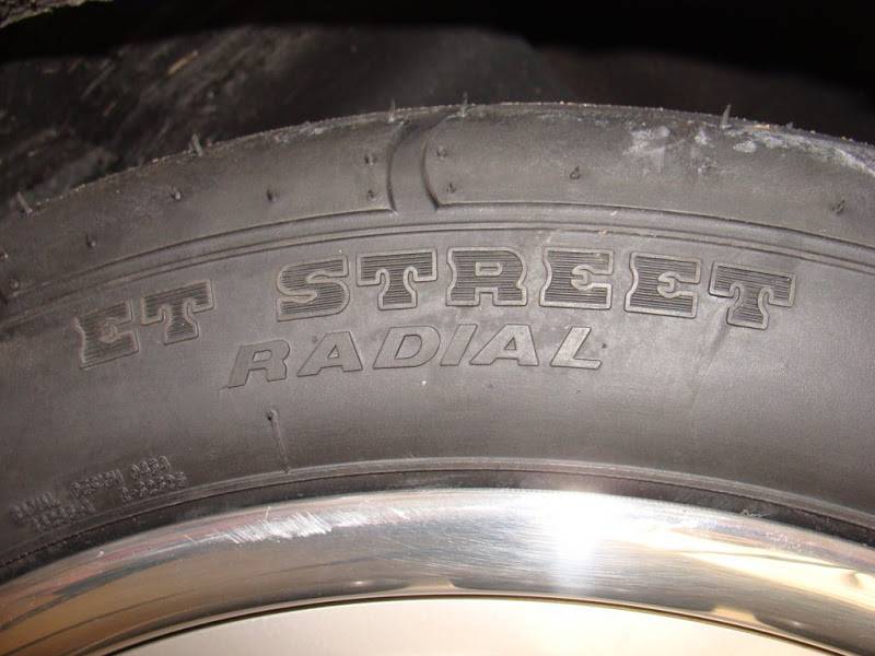

I had a set of et street dr's on stock rims, and they were ok at best with the stock motor and s-trim. I could not stall the car off the line with any consistency on the dr's though.
The 285 toyo proxes t1r's on the car now are good for 1.8 60's off idle, and stalling is useless with them. But as you see, these tires give up fast under higher boost. The dr's did not do this ever - just a chirp. I ran a set of bias ply inner tube et street DOT tires at SSHS8 last year, and it ran the 11.7 with them, but I did not like the way they drove on the big end, so I sold them.

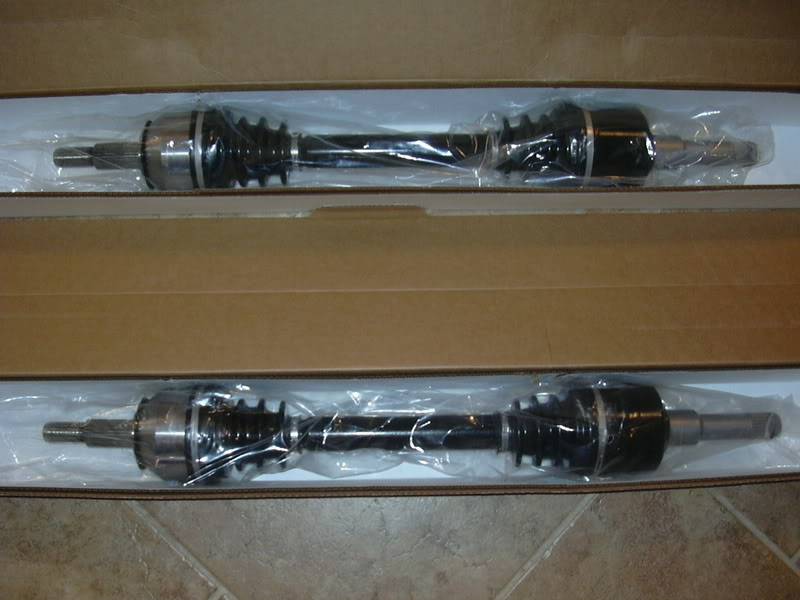

The Mark has the hardware for slick use. It has ARP chromemoly steel racing studs, and a set of Raxle t-bird supercoupe half shafts.

Your only realistic choice is the widest drag radial that will fit. I have had the ET Streets and doubt they will hold your power levels, so you're left where a lot of high power street cars are... you've got to learn how to pedal it out of the hole... consistently.

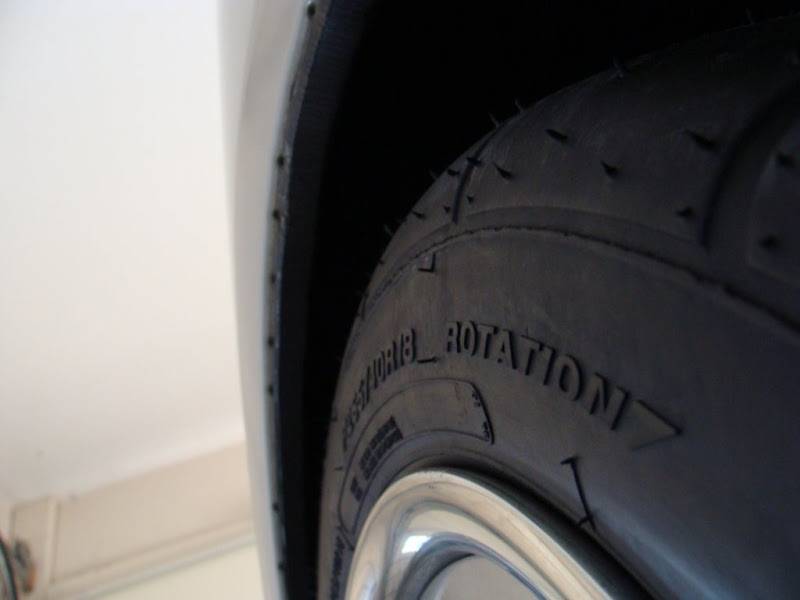

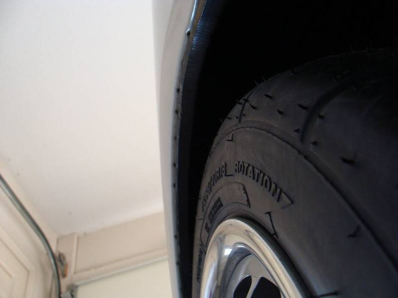

I am heading up to Summit today, and will pick up a set of 265/40-18's MTT-3782R mt et street dr's. That looks to be the biggest MT tire I will be able to fit on the rim. There are 285/35-18 t1r's on it now.

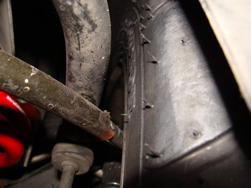

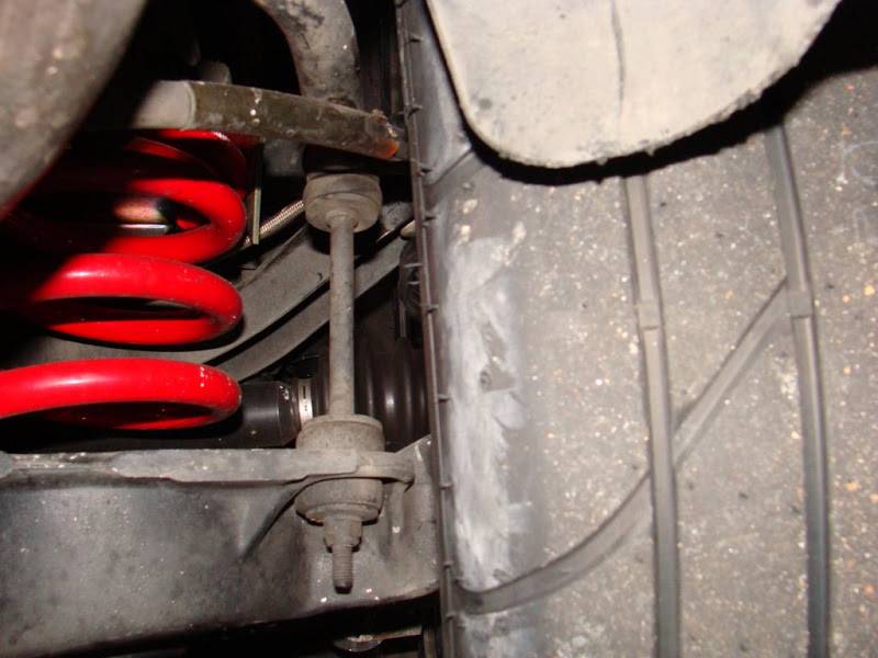

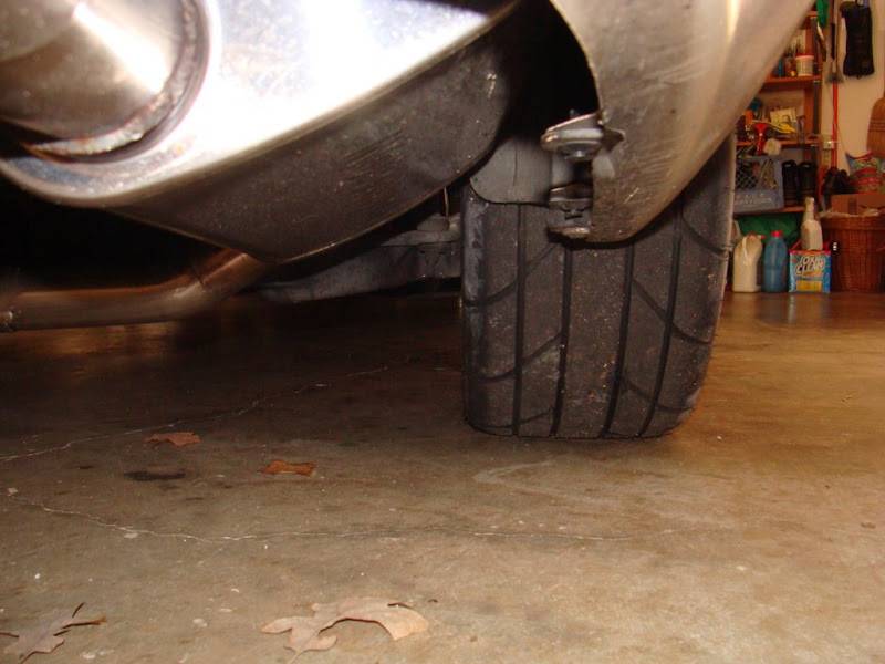

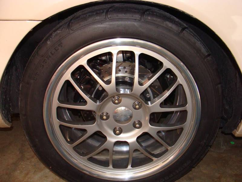

lol Here is the $600 solution... Hope it helps.

Nice I bet you'll be happy. Thats a little different pattern then what I got. Good luck.
Man they hit you hard on the price for the 18" tires. 16" shipped then mount and balance was right at 420.

Yep, my last mt dr's were 16", and it had the tread pattern you have. The tires alone were $500, and the extra hundred was for tax, tire swap on the rims, and road force balancing, so it ended up a $600 day for me.
