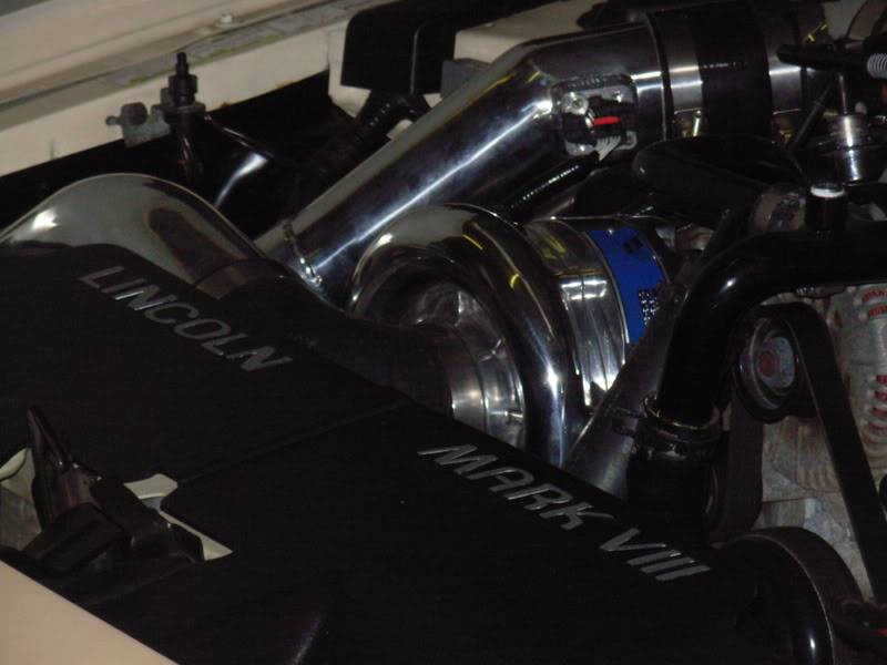

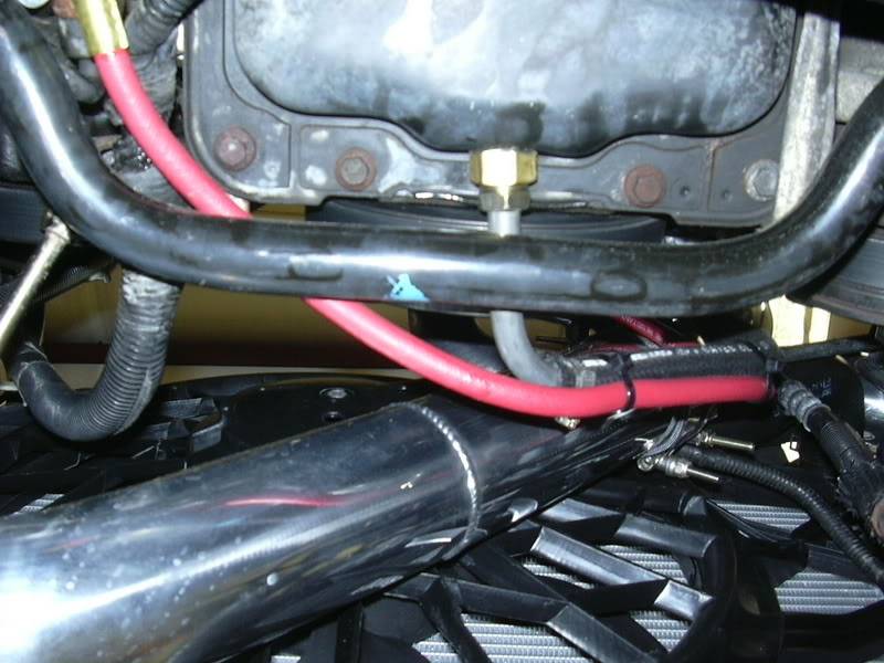

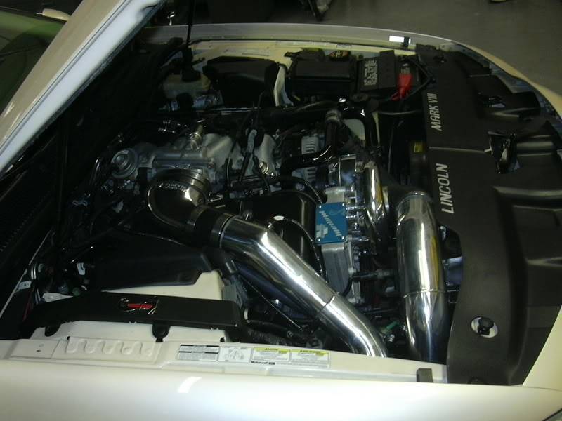

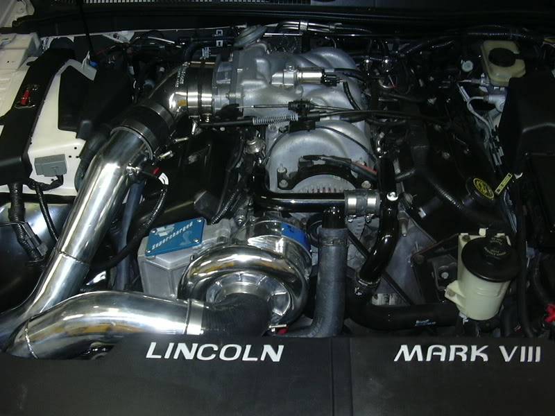

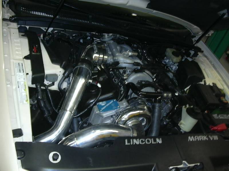

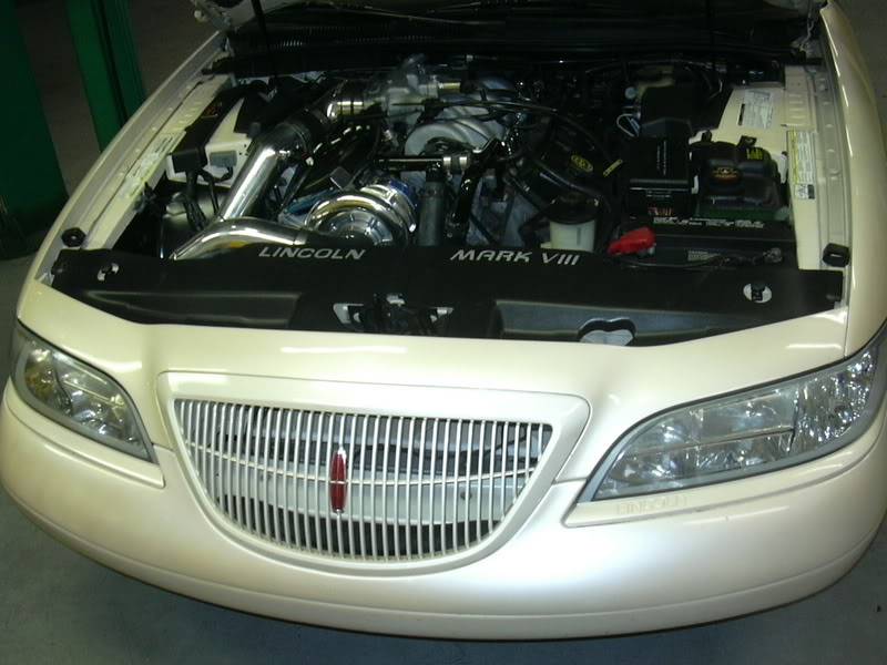

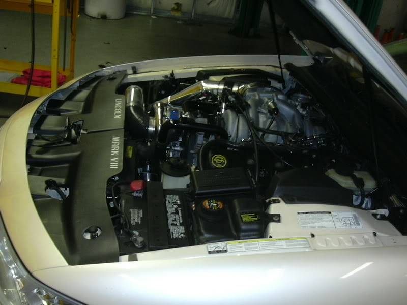

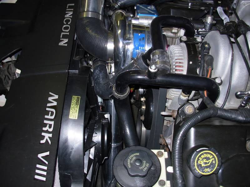

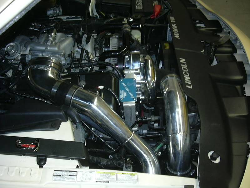

Hi all, Here is a picture and video update of my S/C project. It will be dialed in the next few days, and to the dyno within the next week or so. Enjoy

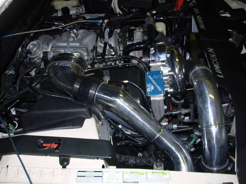

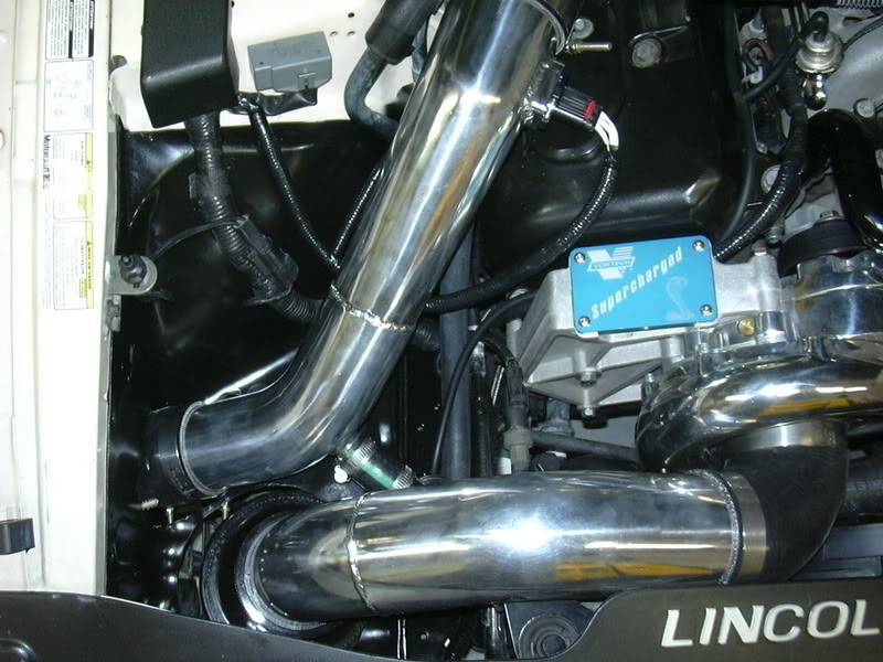

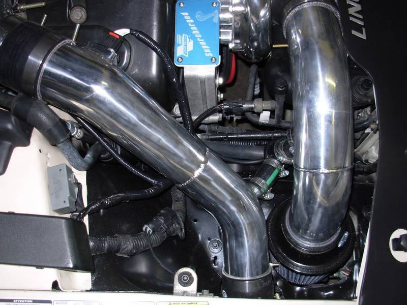

Thanks everyone. This S/C build was professionally managed and installed by Aric Carrion of Injected Engineering - Kennesaw, GA.
ph# 678.449.6871 http://www.injectedengineering.com/
I highly recommend Aric and his company. As you can see, his work speaks for itself
The engine internals are completely stock, and the plan is to lay down 400-450rwhp. Since this is a stock motor, we all know they will not live on the edge too long.
Therefore, real world numbers might be closer to 400rwhp. Aric will decide this while tuning on the dyno. I will post the dyno results as soon as I can, so stay tuned...

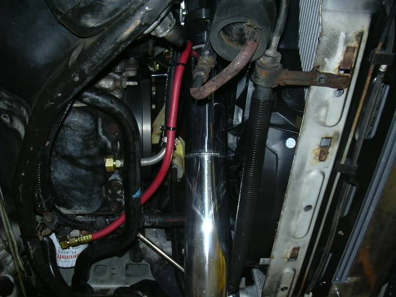

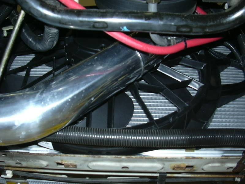

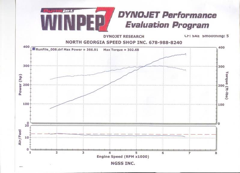

Went to the dyno last night Here is the video of the last two pulls and the dyno sheet.
Aric is going to go ahead and install a Vortech mini race blow off valve to help smooth the idle pulse, and put his boost gauge on it to see what psi it is running at. He still wants to look into a couple things yet, so this is an excellent starting point, or finish point for that matter - since I am already happy with it the way it is.
The weather was nasty yesterday for a tune - hot, and raining, but the intercooler did it's job keeping the air temp only 8 degrees above what the Mark's outside temp gauge showed.
On the down side... I have major traction issues now
http://videos.streetfire.net/video/9...530088e46f.htm

mlschultz is offline   Reply With Quote

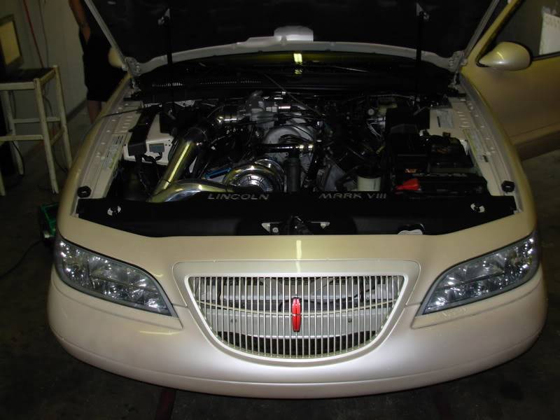

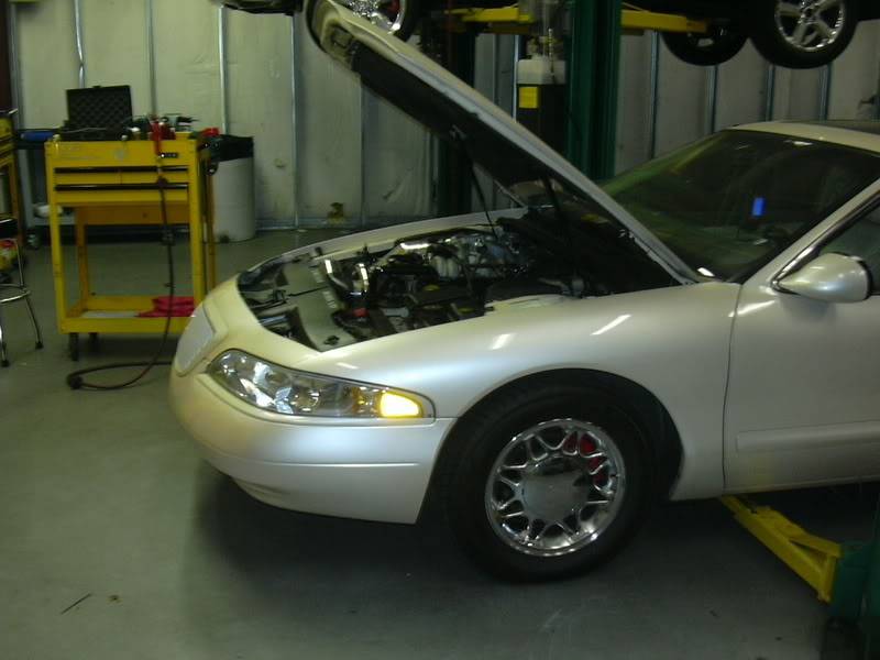

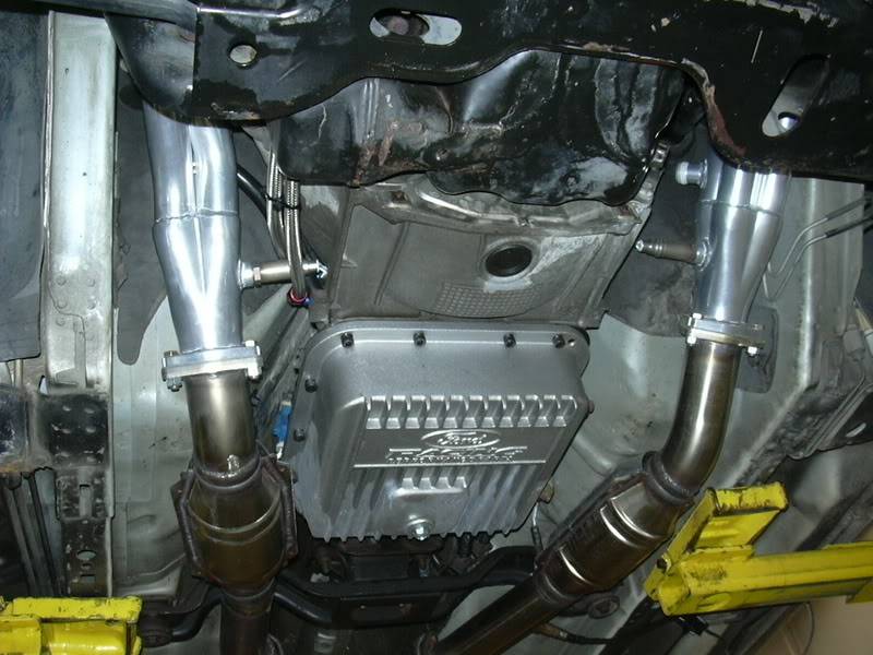

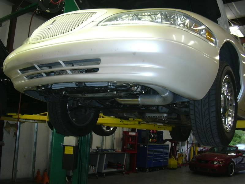

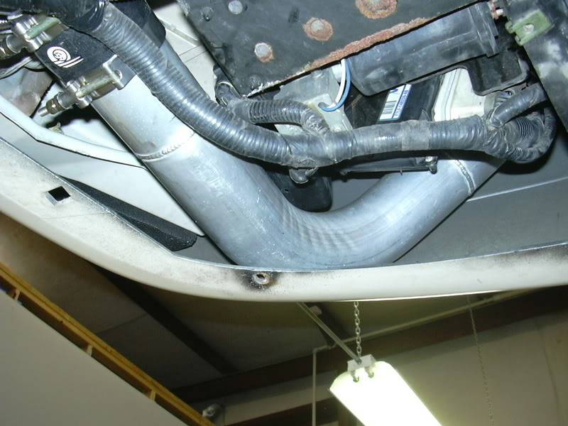

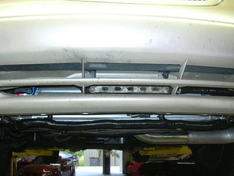

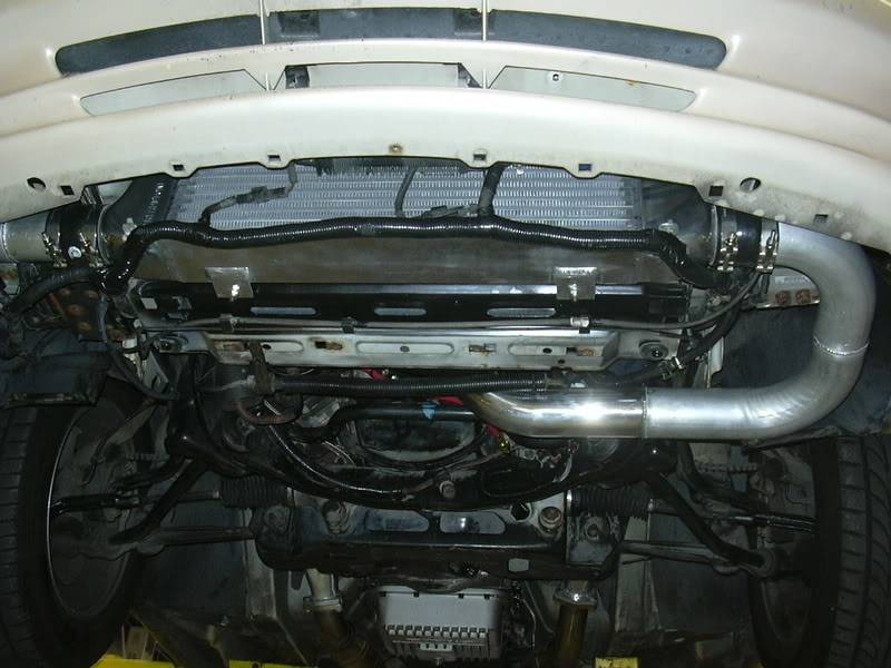

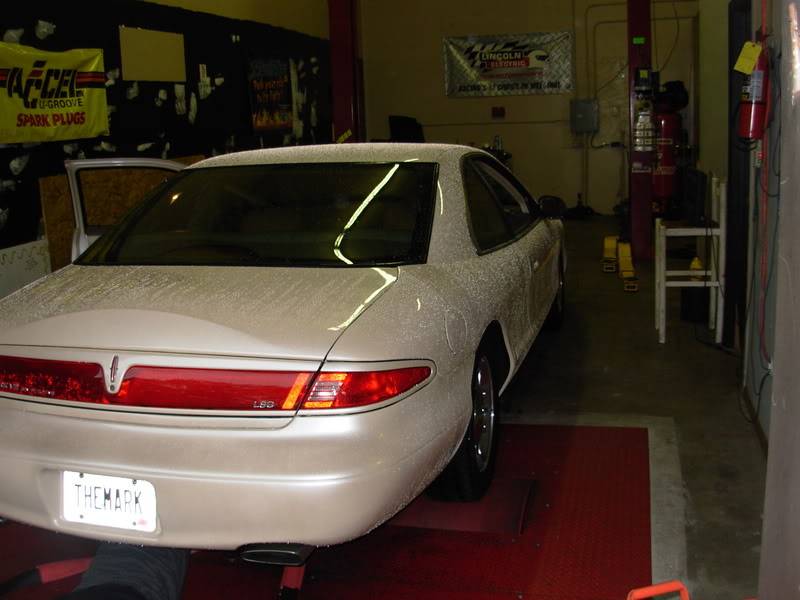

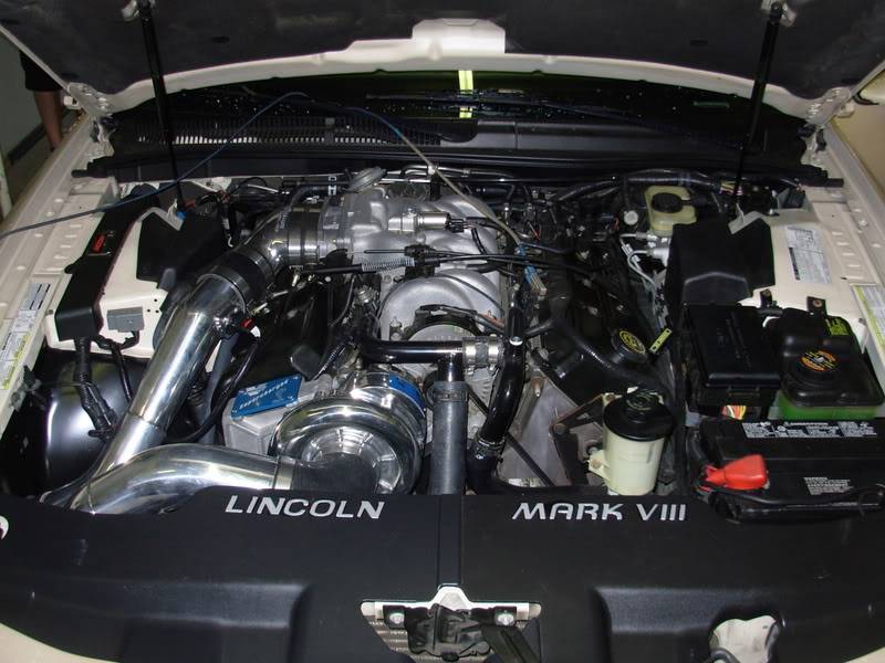

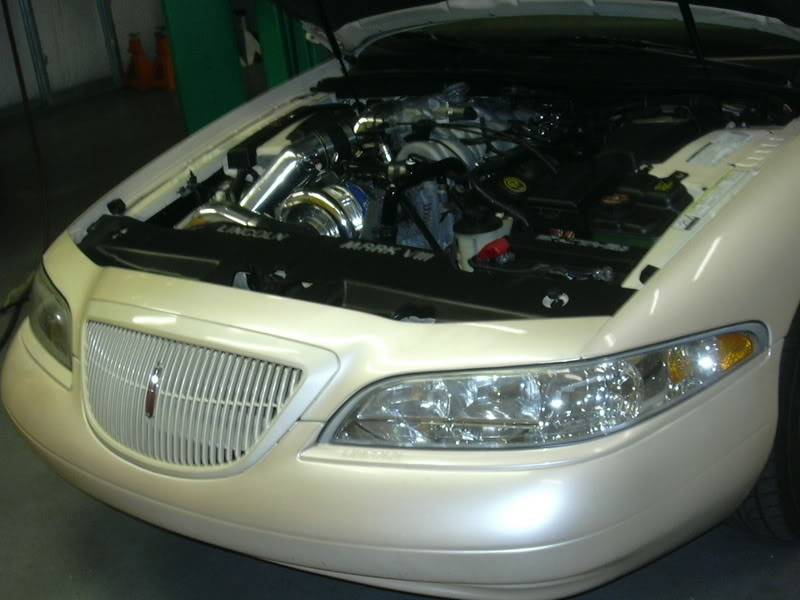

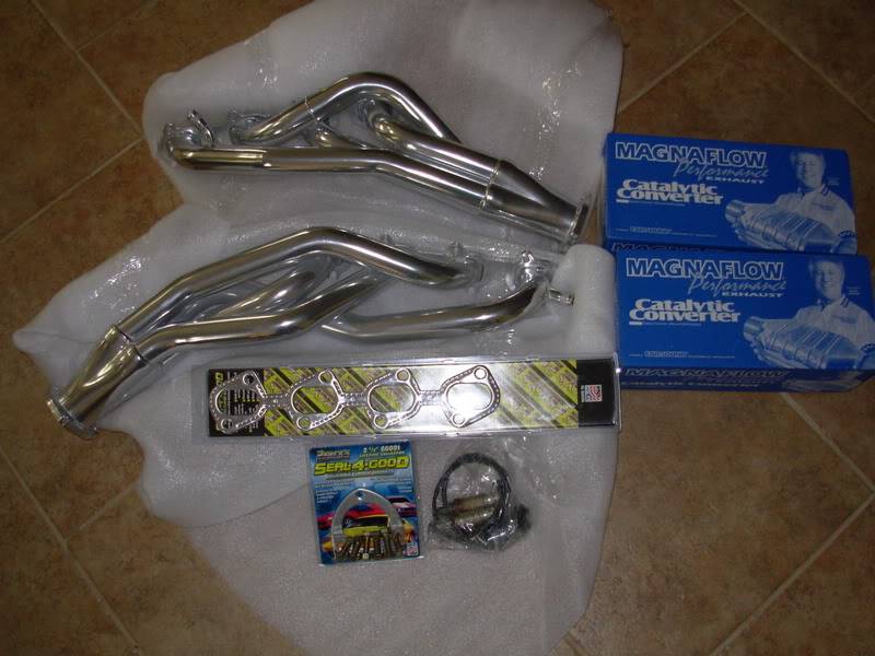

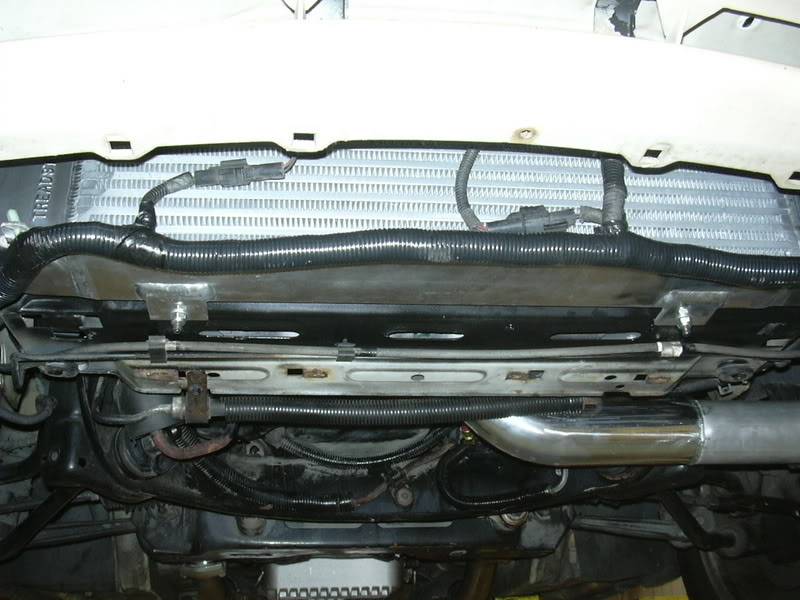

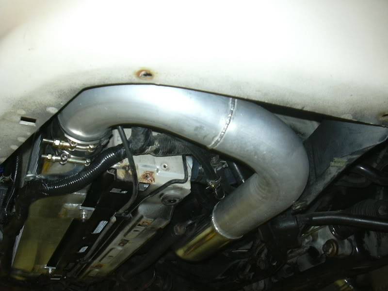

Here are some pictures of the dyno tune

I talked to Ryan today, and he said that Aric has decided to put a Cobra intake on it now. This will impact the T&T I wanted to do on the 29th at ATL dragway. More like July now for the T&T. The vortech mini race blow off valve is on order, and still waiting for the brakes, rims, and tires to arrive at the shop.
Keith, I purchased the Kooks headers, Magnaflow high flow cats, o2's with wire extensions, gaskets, etc from Bill at Super Coupe Performance:
http://supercoupeperformance.com//Default.aspx

Thanks again, everyone. I too am curious what the fuel economy will be, but honestly, ever since I started this build, I turned off the mileage computer on the message center
With the 3600 stall tc, and 410's - it feels like when you have a sling shot pulled back ready to release, when tooling around town.
Here is a list of unique items/mod highlights so far:
Vortech Supercharger Tuner Kit, 99-01 4v Cobra with V-2 SQ SC-Trim Polished
Treadstone Intercooler TR10 24in Long core
Custom Polished Aluminum Intercooler Tubing - 3 1/2" intake, 3" discharge
Siemens Deka 60lbs injectors
Ford SVT Focus Fuel Pump
Balancer
Kenne Bell Boost-a-pump
NGK BR7EF Spark Plugs
Ford Racing Aluminum Radiator 03/04 Cobra. Fits 97-03 Mustang/Cobra
Electric Fan 2002 Mustang GT
MAF for 2005 Mustang GT
MAF Plug for 2005 Mustang GT
VMP MAF adapter for 2005 mass air flow sensor into aluminum tubing
MafXtender
Kooks 3/4 Headers
Magnaflow polished SS mufflers
SCT Xcal2 Flash tool
2 1/2" Custom mandrel bend SS exhaust
PI Single disc 3600 stall torque converter
Dynotech Metal Matrix Drive shaft
Ford Racing 410 gears
Ford Racing Trak-Lok Diff
Raxle SC T-Bird rear half shafts
SCP Pinion Brace
Poly Diff Bushings
SCP Rear Cover Brace
Custom built 500+rwhp racing 4r70w transmission
Ford Racing deep well trans fluid pan
Custom built Ford plate style trans cooler w/SS braided lines
Pioneer in-dash navigation system and multi-media head unit
Myron-Davis DVD player
Stuff on order / not installed yet:
96-98 Cobra Intake
Ford Racing/Brembo 13in 2000 Cobra R Front Brake Kit
Baer Eradispeed Extreme Plus 2 piece Front Brake Rotors for 1999-2004 Mustang Cobra
Brake Pads for 2000 Cobra R/Brembo Brakes
Front Hub and Bearing Assembly for 1999-2004 Mustang Cobra
Baer Eradispeed Extreme Plus 2 piece Rear brake rotors for 1999-2004 Mustang Cobra
Rear Hub for 1999-2004 Mustang Cobra IRS
Rear Wheel Bearing for 1999-2004 Mustang Cobra IRS
Rear brake pads for 1994-1998 Lincoln Mark VIII
Big Ed's Caliper Relocation Kit
Forgeline Custom Wheels (2 VR3P 18x10.5 Powder Coated with a polished lip)
Forgeline Custom Wheels (2 VR3P 18x9 Powder Coated with a polished lip)
LUG Custom Lug Nuts
Tires Toyo Proxes 255-35-18
Tires Toyo Proxes 285-35-18
__________________
Mike
11.751 @ 120.80
SSHS8 Class D
Runner-Up
Old June 26th, 2007, 07:05 PM   #28
mlschultz
Full Member
mlschultz's Avatar
Join Date: Jun 2006
Location: Kennesaw
Posts: 235
Aric called today, and said the Vortech mini blow off valve is now installed on the Mark, and the idle is now smooth
He had time today to put his boost gauge on, and to work on some vacuum line issue, and decided to take it back to the dyno.
I do not have a sheet for this, but he said he dyno pulled 383rwhp with a max of 8psi boost that hit at 6500rpm using a 3.50 pulley with a fat air/fuel mix using the stock gen2 intake. That is good enough for me!
He said we do not need the Cobra intake now, and I am a pulley size away from going beyond 400rwhp. He said this tune is super safe, and I should be able to run it hard all day at the track if I like.
He is now setting up the transmission shift program, button everything up, and also try to locate me some new battery cables because I think they look like crap.
If all goes well, maybe by this weekend I will get to drive the Mark until all the brake, rim, and tire stuff comes in.

I am going to pick up the Mark tomorrow afternoon I stopped by the shop today, and Aric had the Mark completely detailed inside and out including a Zaino treatment for me I truely appreciate that.
He is installing all new battery cables from a Mustang GT, since Ford no longer has a battery cable harness available for the Mark VIII.
He had Joey Bell weld the Vortech mini race blow off valve directly before the intake of the intercooler(drivers side of the IC) - venting to atmosphere. He also kept the bypass valve installed in it's original location. Ryan is going to send me a picture of the blow off valve installed.
He has the transmission shifting done, and we were going to take it for a ride until it started raining. A couple things he noted were...
The TC would unlock when the A/C would cycle on (or the other way around - I can't remember all he said). This is a Lincoln thing to not disturb the passengers with the engine load change. He fixed that.
The other is a little more complicated. He said this car will just flat out totally roast the stock tires now, all through first and second gear by just stabbing the gas.
The problem is while in second gear, the computer is reading 85mph and is commanding third gear, when in reality, it might be going half that speed. When the wheel spin finally stops and it hooks in third gear, the transmission is then commanded to drop back down to second.
The brakes, rims, and tires are on order, and the rears are 10 1/2" wide rims and the tire size is now going to be 305/35/18. Bad news is, it is looking like August time frame before everything comes in.
