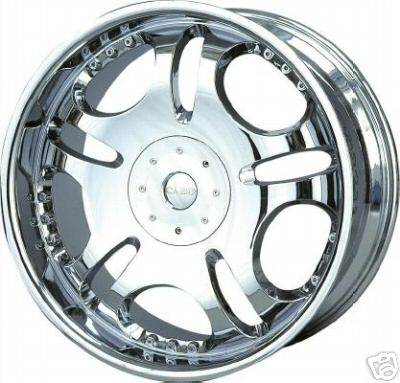

yeah finally got the money for some dubs i want to get the mega 907's how much you think he will want for them wrapped in some nittos shipped?

those are the ones i wanted in black but theyre on a 2 month backorder for the black, i think he said maybe 1495 shipped with nitto tires mounted and balanced, with locks and lugs, btu dont quote me on that

do you think i can haggle

maybe a little, hes a real cool guy and real laid back so im not sure. his prices are better than any other site or place if found. it wont hurt to haggle a little i got 50 out of it soo.....
