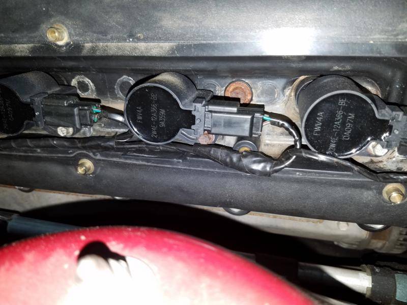

I'll bet that this debate/question could be resolved in five minutes by taking the bank 1 coil cover off...
Yup. Thats the side of mine that was hacked worse, I would see a constant stream of smoke at stops. Sounds like your might be collecting, then dumping.
That's possible. I'll check it by the end of the week and let you know. Probably looking like Wednesday.
Thanks, I got a few days off. I broke one of the connections on my water outlet yesterday. While I'm at it is wanted to check into that leaking issue. The transmission hashop been shifting kinda funny when child the last couple months.
Dry as can be
Dude, you need to pull the coil to see into the plug well. Also, that is some pretty gnarly rust on that hardware.
The oil could be leaking out of the side of the actual valve cover.
Yeah not sure why there is rust. I didn't know I needed to pull the coil out. I'll do that possibly tonight. Do I need to check all 4?
Probably should check all. It's fairly clear from the stains and rust that water has been getting in there.
At least your going down the right path to search for it. If you can get it up on a lift, two things to look for. If its the valve cover leaking, then there will most likely be a straight stream of oil on the corner of the engine going down, right in front of the cats which then will cause the smoke when oil drops hit. The other thing is if the A/C compressor is leaking, it will also cover the underside of the engine, blow back on cats and smoke.
