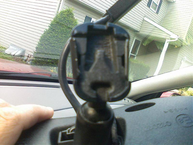

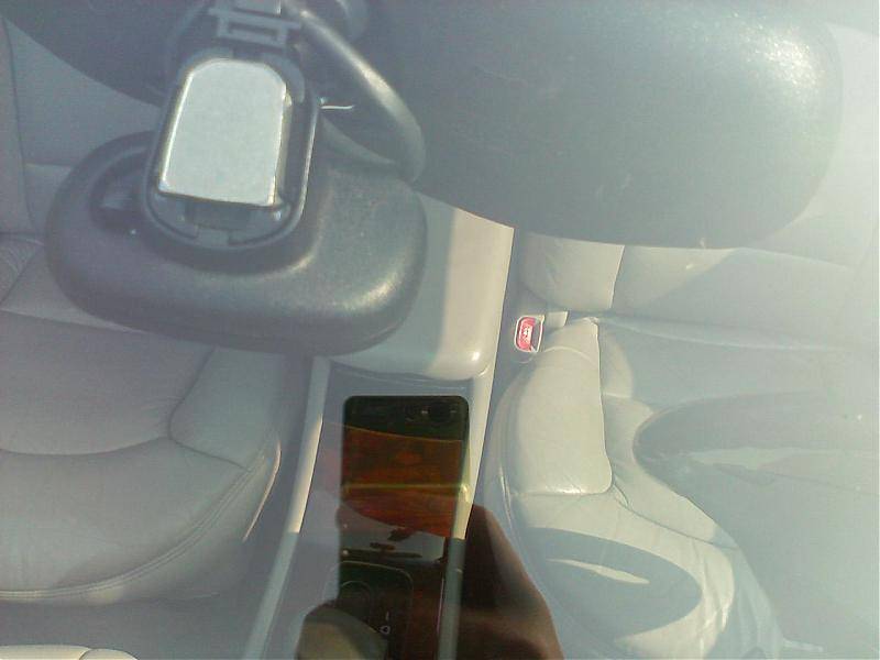

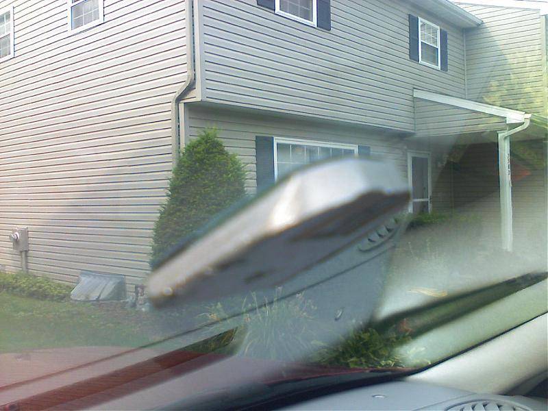

here is what I sent to magna donnley I didn't see a screw.
hmm button looks like a standard ford style button, even has the little dimple on it where the tip of the set screw goes into.
however, I dont see any provision for the set screw in the corresponding part of the mirror.
I have seen some just a friction fit (usually a wavy piece of spring steel) inbetween the button and the mirror assy.
I think its a friction fit type too as I didn't see evidence of the screw myself, thanks though. Flat head in the bottom of the mount is the best way to get it out right?
