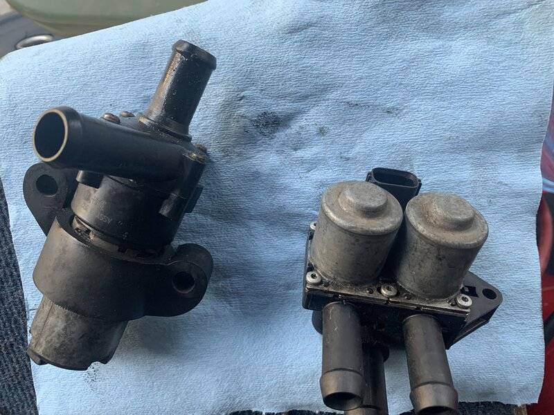

Do the DCCVs fail or could it most likely be the radiator?
I hope to know more once I can get it back home and apart but some preliminary thoughts would be helpful.
Yes, DCCVs fail. Often with internal leaks, but sometimes with external ones instead.

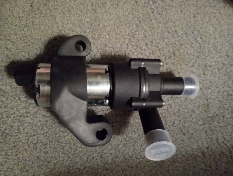

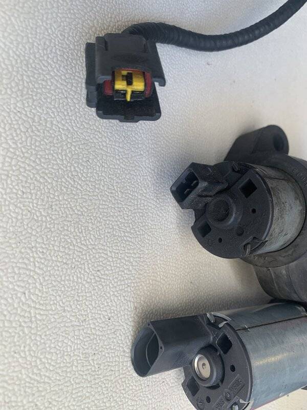

My Aux pump came today, a Bosch 073 rather than 071…BUT the connector is the wrong type. Seems I have a few options:
1). Return it and try to get an 071.
2). Find a connector that fits the new aux and splice it in.
3). Find an adapter that will work between the connector and the aux pump.
