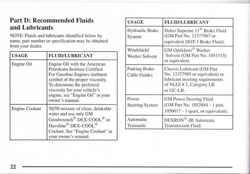

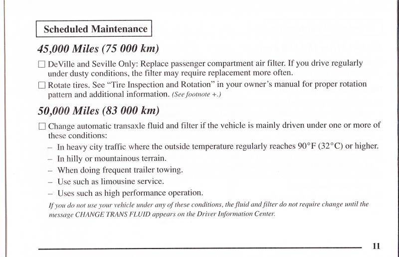

A transmission flush actually differs from a fluid change, in the fact that when you flush a transmission, you use a machine to run fluid through the transmission, which can (and has on some occasions) move dirt through the transmission and into places it doesn't belong, if not done properly. Cleaning the pan and replacing the filter first would help, however many people don't trust it all together. All I've ever done is drain the transmission, draining everything I can manage to drain, replace the filter, add a drain plug (all should have had drain plugs from the factory), and replenish with the proper fluid. I've never had a problem when doing that.
If you do feel the need to replace what's in the torque converter, lines and cooler, you can disconnect the return line and let it run into a bucket while a parter is there to shut the engine down once the fluid stops running out. I never trusted this method, as it can potentially allow the pump to be starved of fluid for a second.
In my opinion, a transmission fluid change should be done every 30-40K miles, irregardless of driving habits or the color of the fluid. I believe that the ideal operating temperature for an automatic transmission is best in the 160 degree range to 175 degree range. Some disagree, however too cold and it will create sludge, just as your engine will if it never reaches a proper operating temperature to boil out moisture in the oil. Hotter than 175 or so, the fluid life begins to deteriorate.
On the Cadillac forums the general rule of thumb was to wait for 100K miles, or until the car told you to via fluid life monitor. I always thought that was insane.
