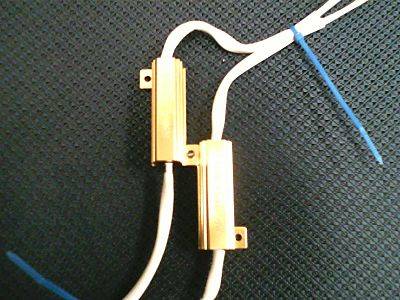

4x 68-SMD red LED bulbs, socket 3157 (ebay auction 251466777460)
4x 6 ohm / 50 watt resistors (ebay auction 360736287196 )
1/8th inch rivets
As time passes, the auctions will become invalid but for now - enjoy! I have no relation to the sellers.
You'll need to use two resistors for each side, both connected to the blinker wire. I riveted two together, then combined their + wires into one wire and their - wires into another. Resistors actually have no polarity but it's easier if you think of it that way.
I then installed a pair inside each rear fender, mounting them to the inner wall in the hollow area between it and the outer fender. This means any heat given off (and they get HOT) cannot harm anything else in the car. I riveted the pair of resistors in place using an existing hole in the panel. This makes sure it can never come loose and burn/melt anything.
On the tail light circuit, strip back the insulation on the orange/blue stripe wire and connect the + wire from your resistors. You can connect the resistor's - wire to any ground source, including the black wire in the tail harness.

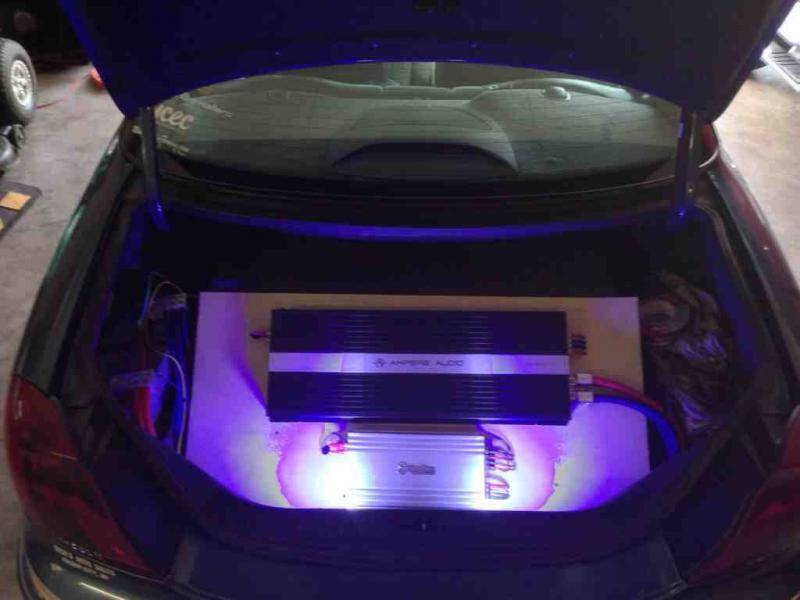

I actually have blue and white LED panels in my trunk - they cast a really weird lighting effect, which becomes even weirder when coupled with the HDR effect of my camera.
