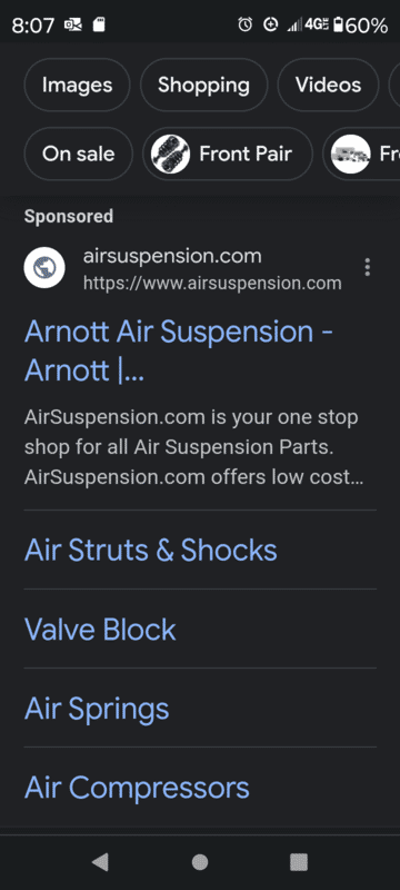

This is why. I even took a quick glance at the website, and nothing was mentioned about coil spring conversions (that I saw anyway).
