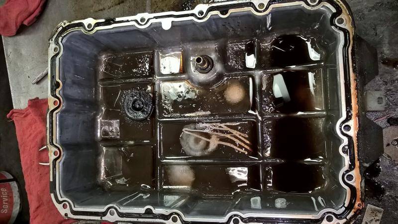

Thanks for the welcome! Here is a photo of when the pan came off. Before the pan came off, he ordered a part that he thought was going to solve the problem as he was familiar with these transmissions, in Mustangs and some other cars as you mentioned. I think it was a solenoid, can't recall now now for sure. Don't know if the photo shows it well, but it was full of metal shavings. And the color looked bad also. I also have a 98 Mark VIII Collector Edition with 145k miles and about a week after getting the LS back, I took the Mark VIII in for a trans service after appox 30k miles and it looked nice and red, much different than the color that came out of the LS.

I have no idea how it got that bad, we only had it for about 2,300 miles before it went out on us. Not a nice way to start our LS journey. Here is my Mark VIII with 145k miles on it when the pan was dropped for a service a couple weeks after the LS problem. Quite a difference.

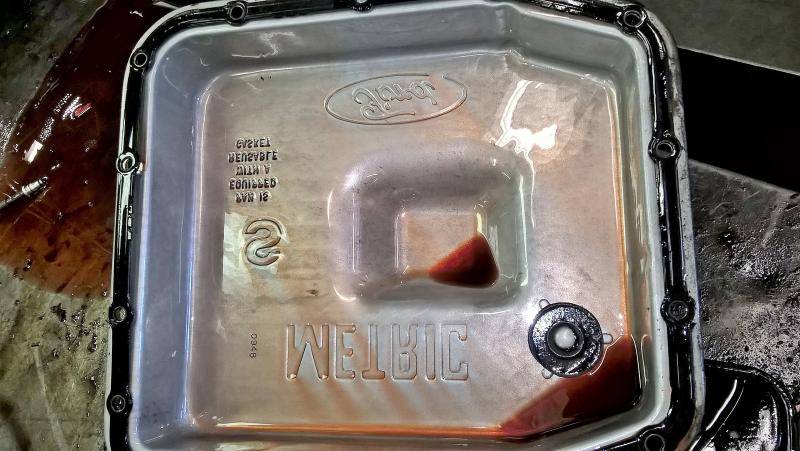

That pan is so burnt and busted I wonder if it got towed improperly sometime before you got it. Cant see a 50k mile car being that bad.
I am sure it was on borrowed time for that 2300 miles, you just didnt know it. My pan looked like your Mark VIII did when my tech serviced it, 101k ish miles.

We just drove it normal, haven't even used the manual/auto (or whatever it's called) shifter yet. Guess it was just ready to go unfortunately for us.

Why the pan looked like that, I'm not sure. It's very doubtful the fluid was ever changed in those 13 or so previous years. I imagine it was on it's way out when we got it and after a couple of trips between LV & LA and some city driving, and with the known issues that Lincoln never corrected, well, I don't have the answer for sure I guess. Thank you for taking the time to add to this 04_Sport_LS as it for sure will help someone out.
As to why your tranny pan looked like that,,, maybe... :
I'm sure I'll be corrected if I am wrong... but IIRC there was an issue with early 2004 and ealier transmissions having issues,,, because of the compounds used/not used in the transmission fluid at the time. Ford had a TSB, (technical service bulletin), which called for putting in the additive in
if customers brought their vehicle in for other service,,, or complained about transmission issues. IIRC,,, the additive was some sort of "friction modifier".
From my understanding... some time in 2004,,, the factory transmision fluid was re-designed with the additive incuded.
When I found out about this,,, I had my local dealer check the service history of my LS... and found out the additive was put in the transmission early in its service history.
Being that there is a difference between a TSB,,, and a recall. Many people may have not found out about the issue.
If the people that traded in the LS you now own,,, without finding out about the issue... and the dealer that sold you the vehicle didn't know about the issue,,, then unfortunately you suffered the consequences. Possible that the trans was beyond repair when the vehicle was traded in.
