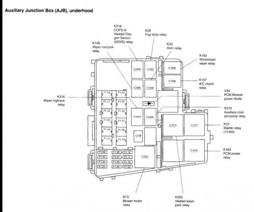

Being that the wires were exposed to one another and having a blown fuse, I wouldn't be surprised if a relay or two is burned. Also check that diode outlined in the diagram and all other fuses and relays in there. Hopefully there lies your solution. Best of luck!
Here's a diagram to help you pinpoint the relay(s).
