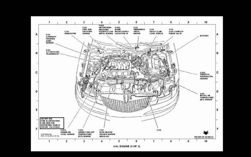

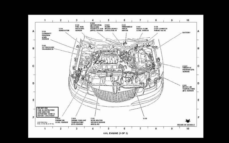

This is from my 99 manual. Should be the same as 01.

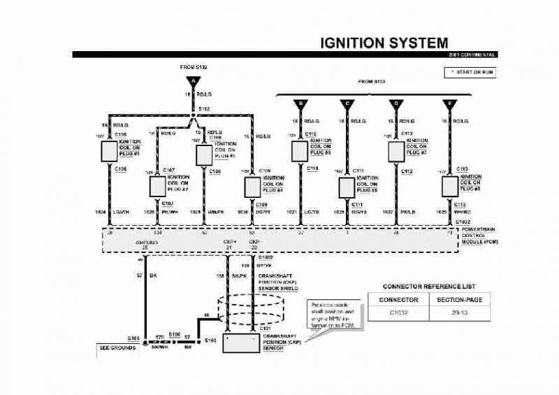

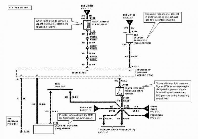

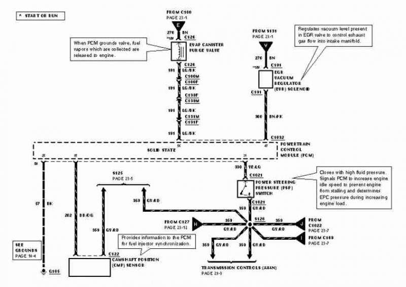

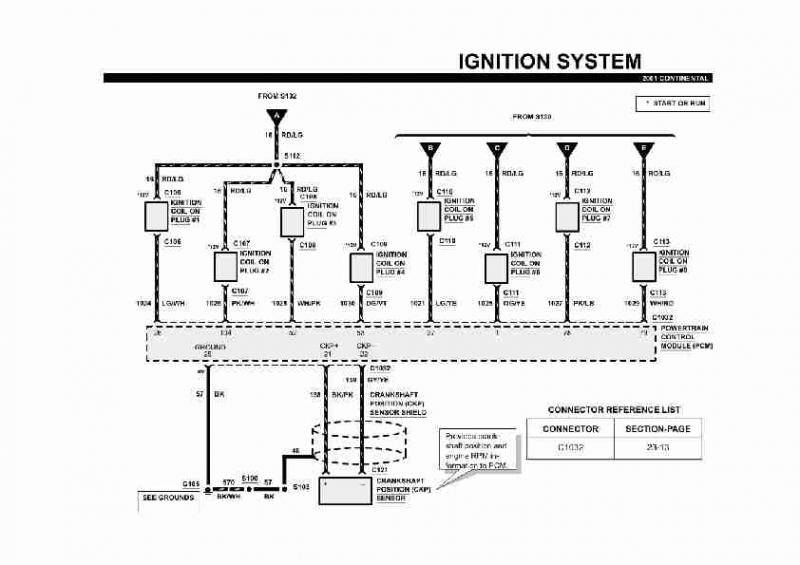

From the wiring diagram it looks like your looking for a two wire connector with one wire that is Dark Blue with a Dark Green stripe, and the other wire Gray with a Red stripe. Not sure of the stripe color on the Gray wire since the color abbreviation chart shows red as r only and has no info on RD.
I found the wiring diagram from 01. Same location as my first post. Looks like different color wires than my 99 diagram says.
