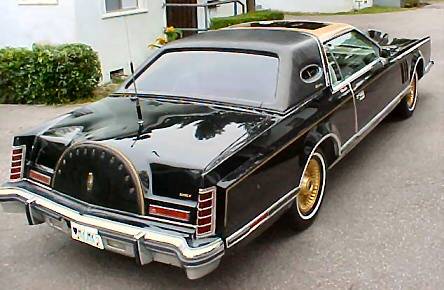

As for the options on the Diamond Jubilee, true, they had many standard features that were options on other mark v models, but moonroof(which most of them had) and the suretrack system were options.Even though I have sold the Jubilee, I will always have a soft spot in my heart for that car.
It was originally all gold but I grew tired of everything in gold so I painted it black, still leaving just enough gold to make it attractive.

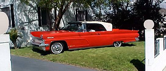

I sold it for a lot less than I wanted because I needed to make room in the yard for a garage that I am building for my 59 MkIV convertible.

That looks great. Gee, wish i had a chance to get that one.

Right now, my 59 convertible is taking center stage for the foreseeable future.
