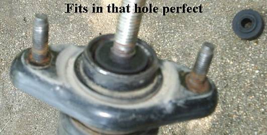

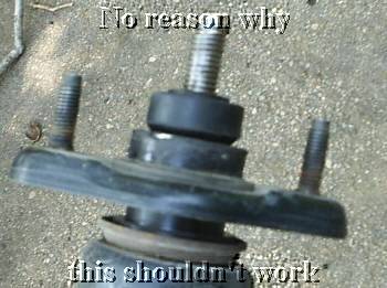

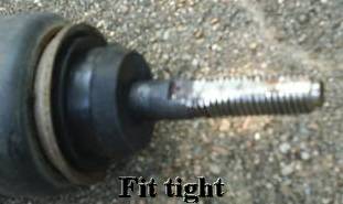

Hay guys look what I came up with, maybe some expert could tell me if this is a good idea, I went looking for rubber mount and found them at O'Reilly Auto Parts, I decided to do this because I haven't bought the T-Bird shock yet, until then this will have to do for now, I don't know how long this will last, but when I put this together it was pretty solid, nice and tight, so really I'm not worried at all, If any body think differently please let me know, I believe my shocks are still good that the reason why I did it that way, But I will change them so what you all think.
Check these pics out.
All opinion welcome

Looks like a good jobe ROPE... If it works fine... Use it!!!! When I did mine, I went and got the dealer mounts... $32 each, and the T-Bird Sensa-Tracks. It worked OK. I thought it was better than the $150 replacement shocks... and that is for only the shocks....

Looks great! This kind of stuff is what these forums are all about.

Looks good to me! great fix!! "Necessity the Mother of Invention"

Were you able to use the same 1/2 inch shock bolt, or did you have to get a 3/8?

Every thing are the same, except for the rubber mount.

I used a digrinder to cut the old BS out.
I didn't have a 3rd pice of rubber you have in the picture.

If you install T-Bird shocks use the rubber bushings that come with your shocks on the top and bottom and that one that you get from o'rielly's in the "HELP" aisle,shown in the pic,in the middle. works perfect I did it on my Mark,and got rid of the "clunk-clunk" in the back. and save about a 100.00 bucks!!
