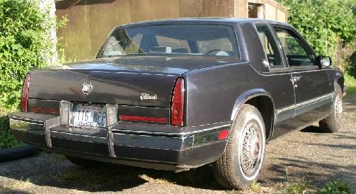

I rescued my father-in-law's 87 Eldo from a field where he parked it 2 yrs ago. Said the alternator quit charging the batt. So, I got a new battery and tried to start it: No crank at all, and with lights on turning it to cranking position doesn't dim the lights at all. So I took off the starter & had it tested....it's Fine! SO...what could be the problem??? Anyone who has any ideas would be much appreciated. Soon as I can get 'er started THEN she'll get cleaned up!

Well I looked & looked *Looked some more, and finally learned about the anti theft device: when the battery goes dead or is replaced, the anti theft activates, causing a no-start. You must lock the doors with power door locks THEN unlock drivers door w/key and Voila! The starter will now get juice. It still wouldn't start, though, after sitting 3+ years. I pulled out spark plugs, squirted 3-4 oz. light oil in the plugs holes and waited a couple days during which time I changed the oil and filter. Put in new spark plugs, cranked it up and after 5 tries, it fired up!! Runs GREAT!!! Took 2 days to wash it 3 times just to get the exterior looking good again, the hood was worst and I got some color-back car wax and it is much better. Yesterday I sold the car for $1300!!!!!!! Thanks for your advice

87 Eldorado bought from my dad-in-law for $100 and fixed for price of 8 spark plugs and 5 qts oil & filter. Runs well and sold for 1200 profit. Not bad for a couple o weekends ...would have got it running quicker than that if it hadn't been for all that beer!!
