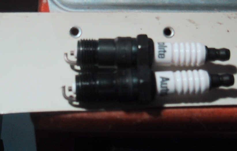

Having said that, now the choice is not only heat range but material also. A lot of people shun copper plugs, wanting platinums, silver or iridiums for the pizzazz factor. IMHO copper is the best performance and most certainly the least costly. Being this economical, fresh new plugs beat old exotic plugs any day of the week.
Anyone else do this?
Notice the top plug's electrode compared to the standard one at the bottom. I gapped these Autolite copper plugs at 0.048". Then I filed back the electrode and then radiused the end of the electrode. This is done to improve spark exposure and flame front for better and more complete combustion. Some call it the nitrous mod.

If anybody gets some dyno time, that would be a great experiment. Start with the stock plugs, then go 1 degree colder with the autolites and then 2 degrees colder with the AWSFA-12C Plugs as recommended by Chris. Seems like alot of guys making more than stock power take the 2 step colder approach. There has to be something to it. I personally would love to see the dyno numbers.
yes, I did this for my 89 LSC. It is supposed to help with low end torque....dyno test i saw gained over 20 lb/ft below 2500 rpm

How delicate is the work to file down the plugs?
Just use regular files, or sandpaper. Sorry im new to performance i usually keep to electrical.
Big Joe
Posted by: MonsterMark
Yep, file and sandpaper till you get a nice rounded edge similar to the one pictured a few posts back. Pretty easy to do.
Posted by: driller
Tip: Use a thin metal shield between the ground electrode and the center electrode to protect the center electrode from the file. I used a small paint trim shield.
Lightly clamp the spark plug in a vise or use a small C-clamp to clamp it to a bench or shelf. File the ground electrode back at least midways to the center electrode. I used a small 3 sided file. Then round off the square end. Finally, smooth any sharp edges with emery cloth or crocus cloth and inspect carefully. Be sure to recheck the gap afterwards.
