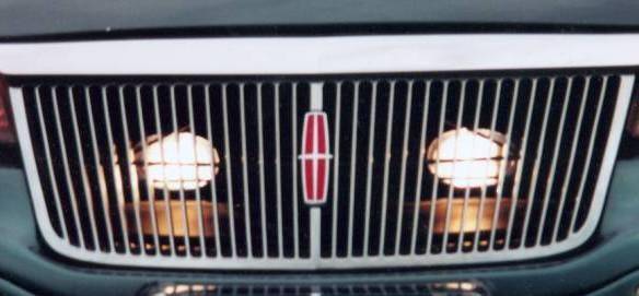

I don't have any good pics of it, but I mounted mine to the crossbar behind the grill. You have to pull the plastic headlamp access cover off to access that area. You can barely see them in this pic...

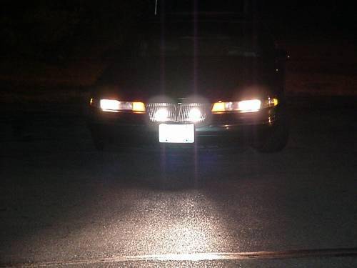

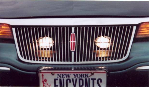

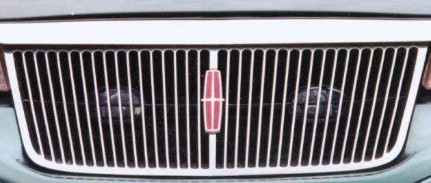

You can do it one of two ways.....you can either take the whole bumper cover off and put them in that way, or you can remove the headlight cover from under the hood and do it that way. Either way is not difficult, but by removing the bumper cover you will make it easier on yourself to be able to screw the lights into the panel.
When I first did this, I just used the double sided tape that was supplied with the fog lights. It lasted for 4 years until I decided to permanently mount them (yeah, it took me a while to decide whether or not I was gonna keep them there). I took the bumper cover off and drilled the necessary holes for the screws to mount the lights permanently. Here is a few pix of what mine looked like.

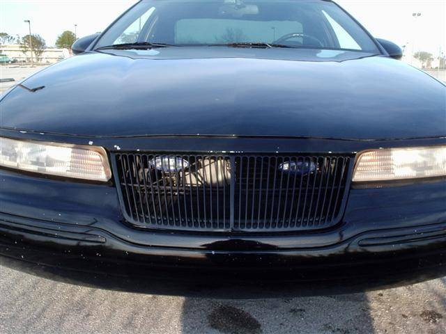

I just have mine mounted to the top of the grill area i just took that plastic trim off that covers the head lights and every thing else, I think its much easier than taking the bumper off just screwed them in permanently. The lights I have now suck I want to get better ones, who makes the brightest out there?
