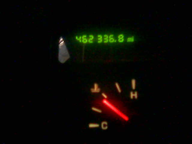

its at 473k now ........ and when is C. Shelby going to make a few Town Cars?

wow you just gave me a smile to how long my town car is going to last i currently have 397,000 miles on my 96
