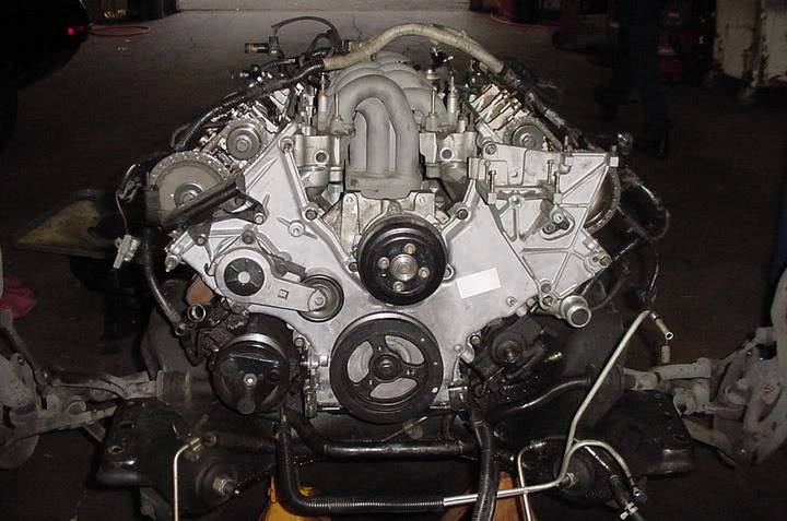

Posted by: BlackIceLSC
I SEE your engine pic....and raise you two more!
There are 2 "primary" timing chanins, and 2 "secondary" timing chains. There is no "service interval" for them. The water pump does not have to come off to change them, as you can see in the third picture. Nor do they have to come off to change the water pump.
