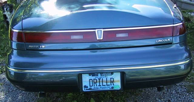

Posted by: driller
This is the best pic I have...
... of what i did to fix mine.
Simply carefully pry out the plastic lens piece. Lightly sand the back side until all the red is gone. Touch up the silver Lincoln Star if necessary. Paint the backside with several light coats of your choice of color(I used color matching touchup paint). Use 3M trim adhesive to glue back in place.
