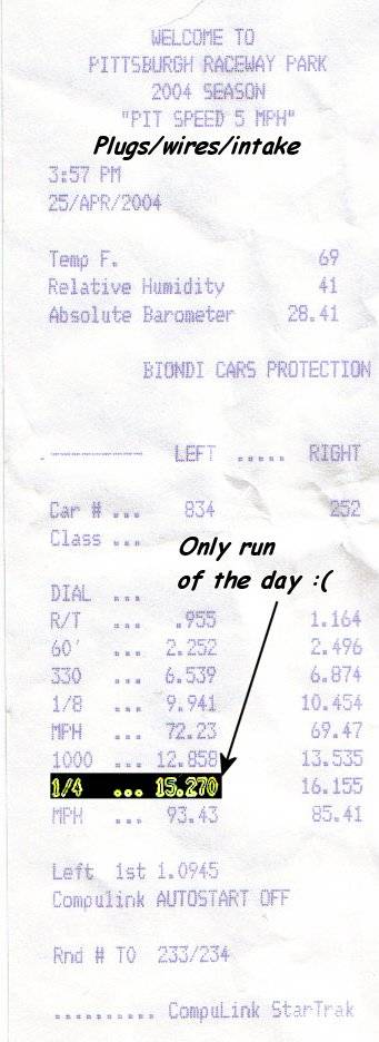

Now.....onto my times.....remember the 15.507 I ran last week....well I ran 15.270 this week, and all I did was change the plugs/wires out in my car. Now, before you think that it is totally possible to gain almost .3 seconds by just doing so (IF you have plugs/wires) you have to know that the plugs/ wires on my car (the 'Barney Mobile' that is) had been in there for a LOOOOONG time. They had been in there for so long that the smallest gap on the plugs was over .65 (and they are supposed to be at like .48-.54.....depending on who you talk to).....and the highest gap was close to .80.....so you can imagine how it was easy to gain better performance from the plugs that I had in, to the ones I replaced them with. Now, I also went with the Lightning spark plugs (part number AWSFA-12C....which are 2 steps colder than the stock 32C's). I also went with the FRP 9MM wires (basically because I do not like the red wires that are only offered by MSD). Then, I modified the stock intake runner to remove the 'lungs'. So, with all that done, and the well used plugs/wires, you can see why the increase (or decrease actually) in times from last week to this week are from. Of course...I need to quit pickin my nose at the lights......
Here is the timeslip:

If you look at your 60' times, you ran .063 quicker right out of the gate, this probably translates into a tenth of a second or so by the time you hit the other end. It is definitely worth AT LEAST .063 seconds. Now take into consideration the better track conditions of your second visit and you're probably looking at another tenth. So that leaves about a tenth or so of actual improvement.
All other things being equal, if you check out this link and plug in the values, you did seem to have better conditions on your second visit. At 0 altitude the air density comes out to 1.09 vs 1.13 for your first and second visits respectively.
http://wahiduddin.net/calc/calc_hp.htm
Run some 2.1s and get some good conditions and you'll be in the 14s no problem.

Kale, that's a GREAT link. Confirms my calc of about 4000 feet density altitude... which I think is high?
Ray, with a gap of 0.065 to 0.080 on the old plugs, I'd say you picked up some there with the new freshly gapped 12Cs. BTW, I didn't have enough gonads to manually shift - so my times are all with the shifter left in 'D'.
