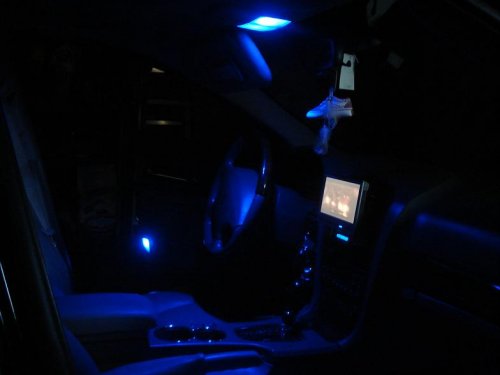

Couldn't really get a good picture of mine, because its hard to catch the blue color on a picture. I love it tho!

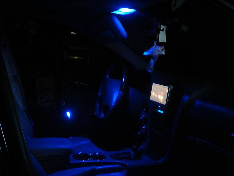

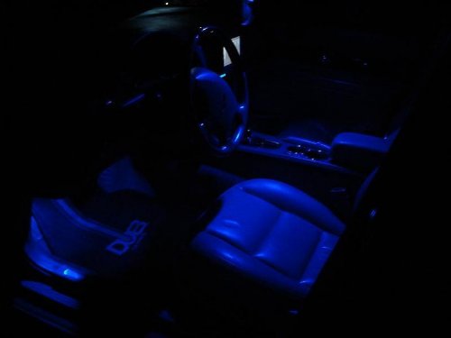

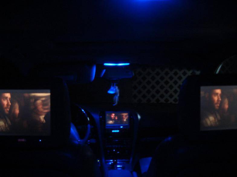

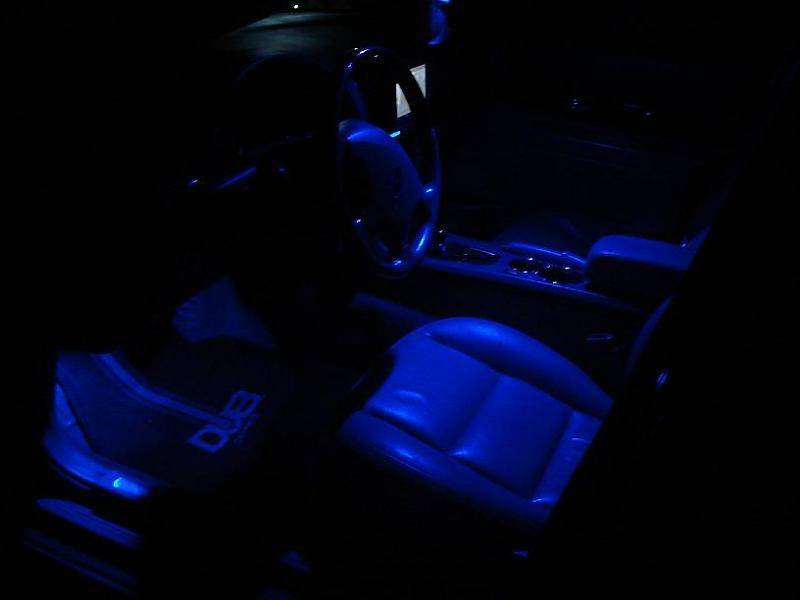

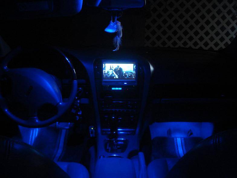

here's a pik of mine. i got them from superbrightleds.com. i also have the license plate bulbs that i got from LSK. you need 4 194's and 3 212-2's for the dome lights. you can put the dome ones in without taking the headliner down but it's a PITA. good luck
