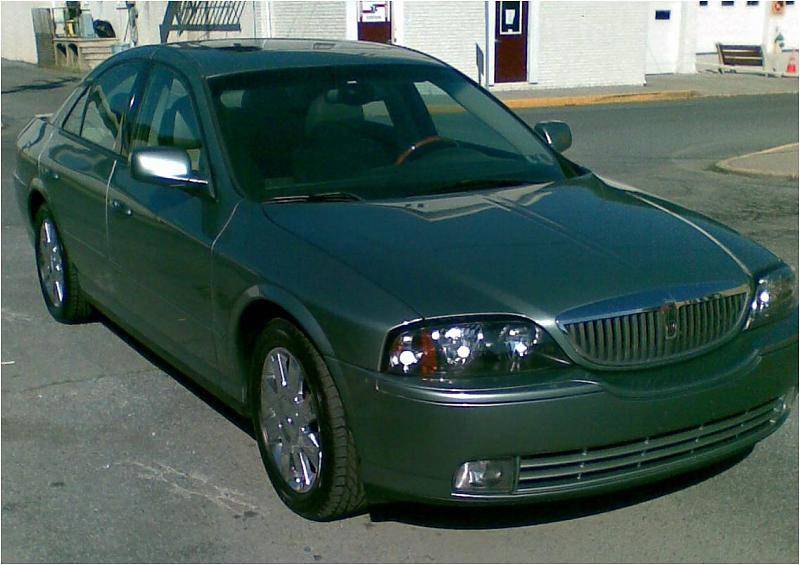

2003 LS Sport - Tundra green, v8, 40,000 miles, seems to be pretty loaded minus dvd navigation. I attached a pic - hopefully it works.
