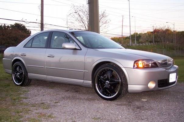

Keep your rim to 20x8.5 and go with a 245/35. That's what I run but some run the 225 or 235. The reason I say go with the 245 because the tires are wider and give you a little more rim protection around the lip of the rim. Now here's something that i've learned. All 245/35 tires are not the same. What I mean by that is the tires vary in thickness depending on the manufacturer. I've seen this with my own eyes. For example, when I had my old rims on I had Hankook Ventus k104 tires. They were ok but had a relatively small side wall. Now when I bought my new rims, I decided to go with the Nitto 555 Extremes because I had seen them on a friends car. These tires are a hell of lot thicker and quieter than the Hankooks. My car wheel well looks fuller and it's not even lowered. Just my experience and two cents. I hope this helps you some.
Posted by: Torx
^^i like the look of yours, and im interested in some rims like yours too..
what model and brand are those?
