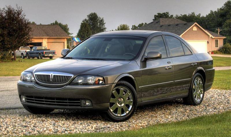

Hello everyone! This is my first post on here but I've been following this forum off and on for over 2 years. I recently purchased a 2003 Lincoln LS Sport (picture attached) and I have a few questions regarding it. Please be kind in your responses as I have seen many answers/solutions/diagnosis in reading before. Using the search feature however I'm not very successful in finding the proper thread. Just a link to a thread would be greatly appreciated!

Beautiful car!!

Love that color!!
