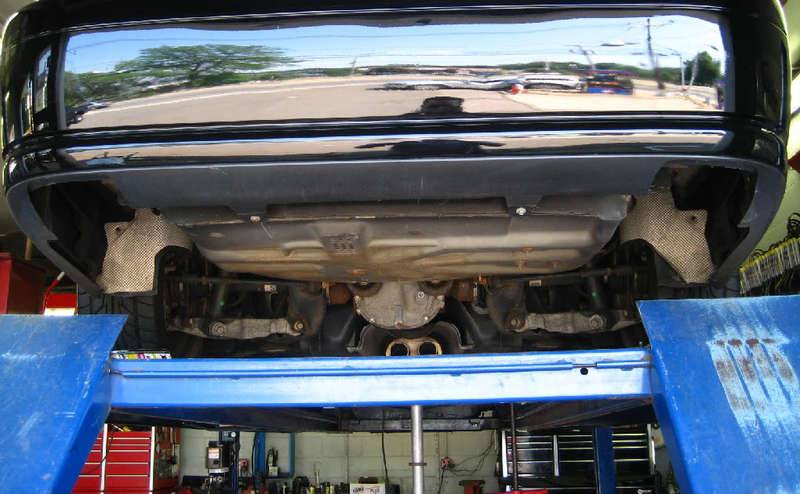

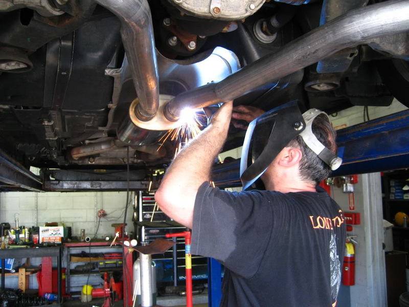

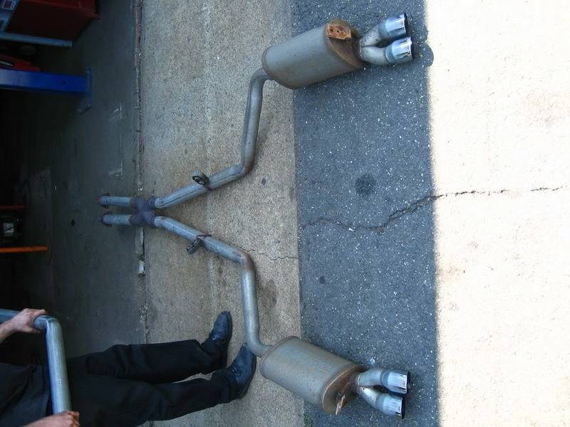

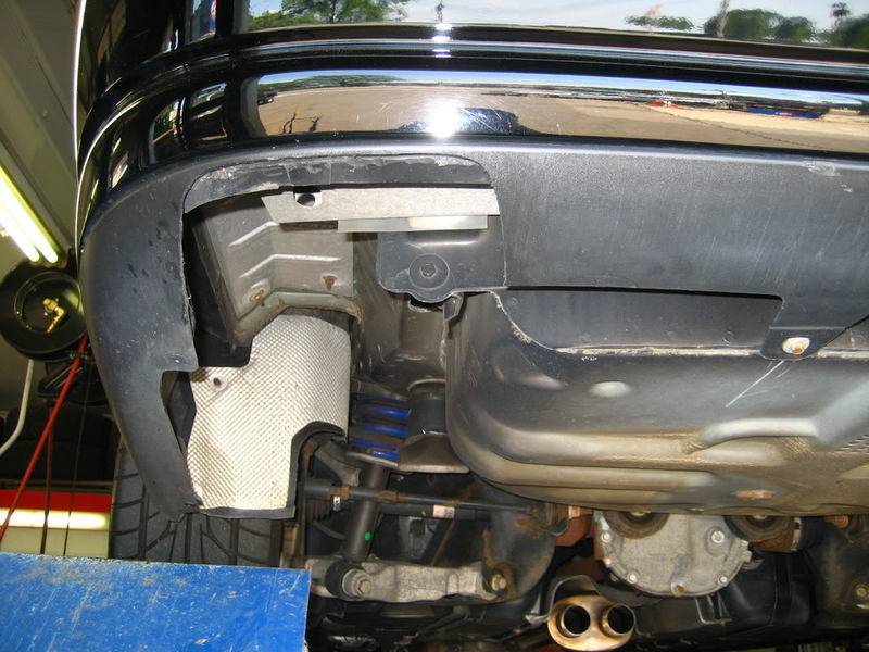

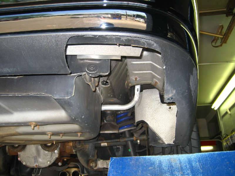

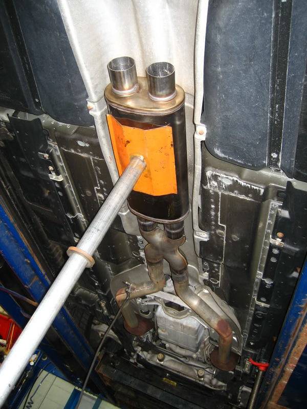

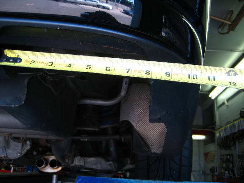

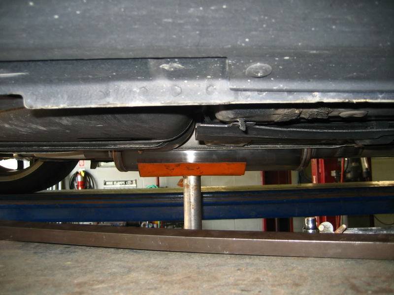

Anyways, here's some pics I took:
Old system:
Trimmed rear valance:
Partially done:
Side view of new muffler:
The master at work:

I wouldn't go with that muffler if your car is lowered. Look at the side picture I took. Nick has Sprint springs in his car with 18s and that muffler is the lowest point on the car. I forget what the actual size is. Hopefully Nick chimes in and tells ya.
