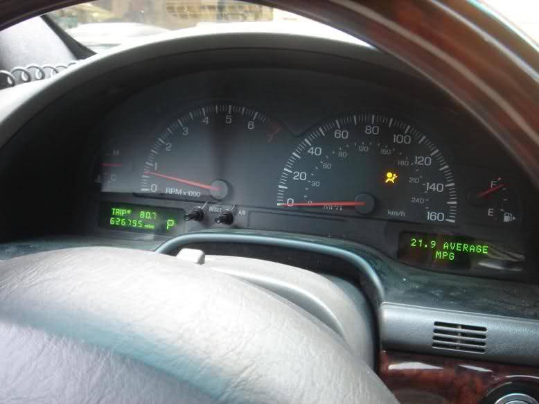

Hey guys this is my first post in the forums. Last night when I started my car the headlights came on but the radio, instrument cluster, and A/C controls did not do anything. I thought I blew a fuse but I didn't. I turned the car off and back on and everything suddenly worked again. Once I got down the road I looked down and noticed that my odometer is now reading an insane amount of miles!!!
I drove it to work today and my tripometer and odometer is adding miles at the correct rate (if I drive one mile it adds one mile). Everything on the car works fine. but my car had 120K miles yesterday and now it says it has 4x that!

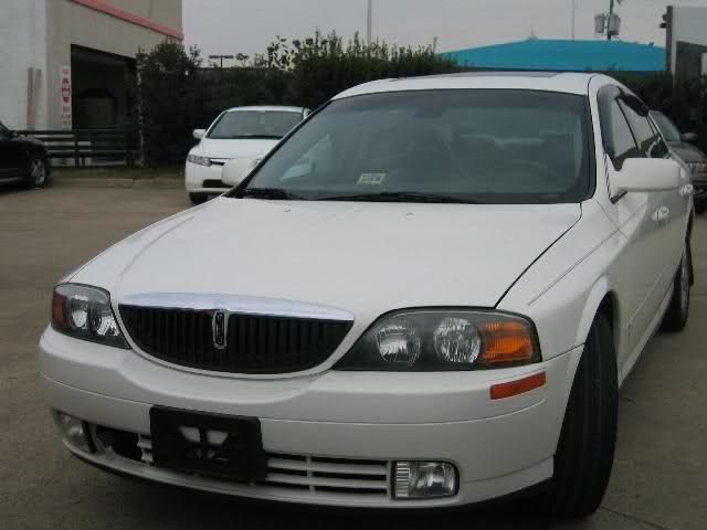

Its a white LS with wood, heated seats and the message center. Here is the day I bought it.
My last oil change was at 123K which was a few months ago. now it says 600 thousand miles but it adds miles to it just like normal.

Just noticed something in that pic because I got in my car tonight and saw 689356 I had to do a double take, there's a decimal point (one of these . ) before the last number on the Odometer. When I looked back I saw it, it's kinda hard to see if you just glance at it.
That odo reads 62679.5
You can see the decimal in the first pic, for some reason though it doesn't appear to be lit.
You say you've had it a couple years? You could easily put 50k miles on in a few years and not really notice it. Pull out your registration and look for the "mileage at titling" line.

That decimal point turns off after you exceed 99,999.9 miles. At 100,000 and up fractional miles are no longer displayed.

My car does not have a decimal point and i don't think it ever has. I guess that is because I bought it with 108 thousand miles and not less than 100 thousand like someone above said. but i do know that I my trip computer and odometer are putting the same miles up at the same rate and my mpg and everything else works correctly. and my airbag light has sporatically about once a month since I've bought the car back in 2006.
my daily commute is about 55 miles and the tripometer and speedometer added like normal today. but its still high!
I'm headed to the dealer. I am going to show them that my oil was changed in May and my window sticker says change at 124K. so maybe they will put it back around 122k

Probably not--there are only ~1.6km/mile; that would only take it to ~192K, well short of the 600K+ indicated. If it went from km to miles, it would have gone from 120K to ~75k, so even that couldn't account for the discrepancy.
FWIW, my '06 still shows the tenths digit on the odometer, and if you look in his first picture you can see where the decimal point would be.
BTW, at this point, I think you're screwed no matter what you do--your car is now a "true miles unknown" vehicle, and I'm pretty sure all states require this to be marked on the title. I know Oklahoma does (been there, done that, got the t-shirt and the coffee mug ). The dealership is probably the only place that will be able to help you, but there's no way for them to know what the correct miles are to set the new instrument cluster (and fixing this will almost certainly require a new instrument cluster).
