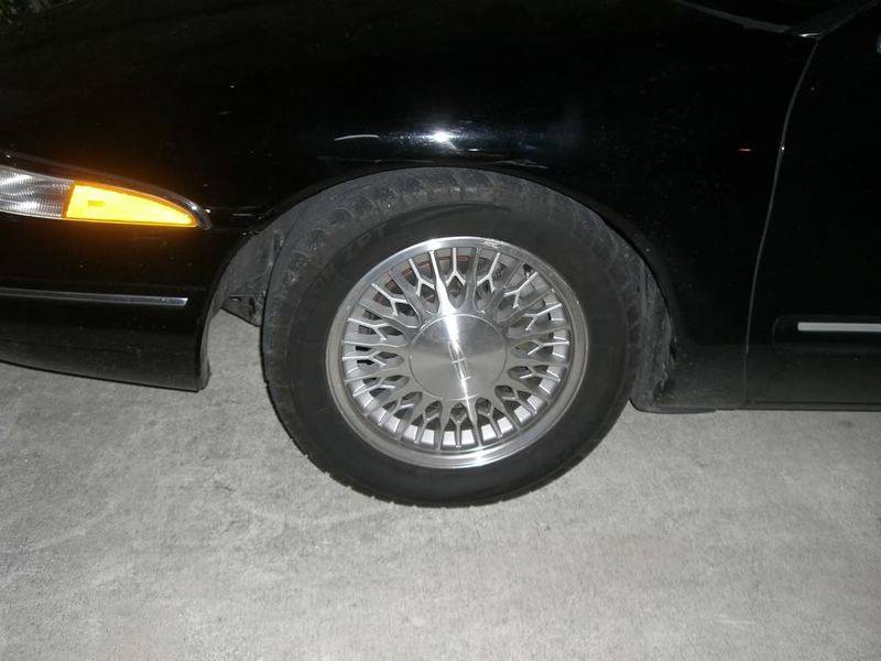

Posted by: jamie97lsc
yup. unity is right, i almost knocked the guy out behind the counter at tire kingdom when they did this to my car...
and this is my other mark VIII the way it should look...
needless to say after 2 attempts letting them try and get it right, the 3rd time i went back i was ready to either fight some fat loser that said oh well there is nothing we can do, or get my money back, i got my money back and a few customers in the lobby im sure, will never go back there either. i ended up going to the ford dealer and had it fixed and driving mint the same day i dropped it off with them. should have gone to ford in the first place.
