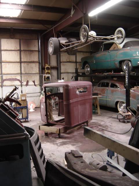

Thanks for all the info. I've inspected the lower ball joint nut attaching the lower control arm and it is not a nylock. I'd guess that is part of the problem. I don't own it yet but the credit union claims to be as low as they are willing to go, but we will see. I have a few hotrod projects and the local shop where I store my crap has a lift, a 20ton press and a full compliment of tools to wreck most anything. I catch a bit of crap for my modern daily but the rent is cheap and we so manage to get things done. I'll source replacement control arm(s) and give it a run. Anything else I should sort out while I have the front end torn down?
