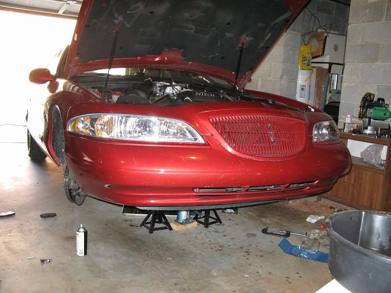

First of all, I did mine using jack stands. It's recommended to use ramps; I second that. You need the car up pretty high to be comfortable. I'm a skinny guy and was a bit cramped.

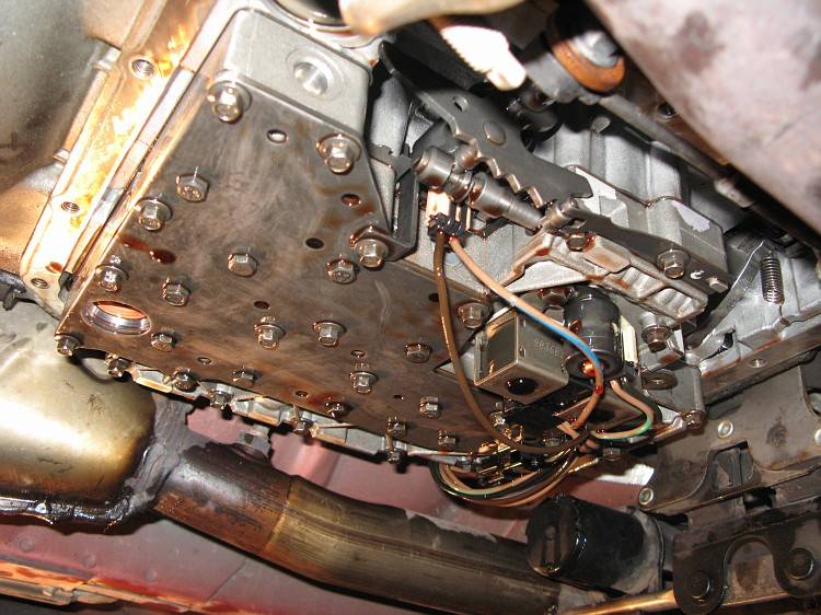

Removing the pan from the car: Not fun at all! The linkage on the drivers side looked to pose a clearance problem, but what I'll call "rubber beer cans" that are attached to the exhaust system really got in the way! Couldn't really figure out what they are there for except maybe in the event of a crash the exhaust doesn't tear up the trannie?
I'm still not sure how I got the pan out, but after much cussing and some "Jedi mind skills" it somehow came free.

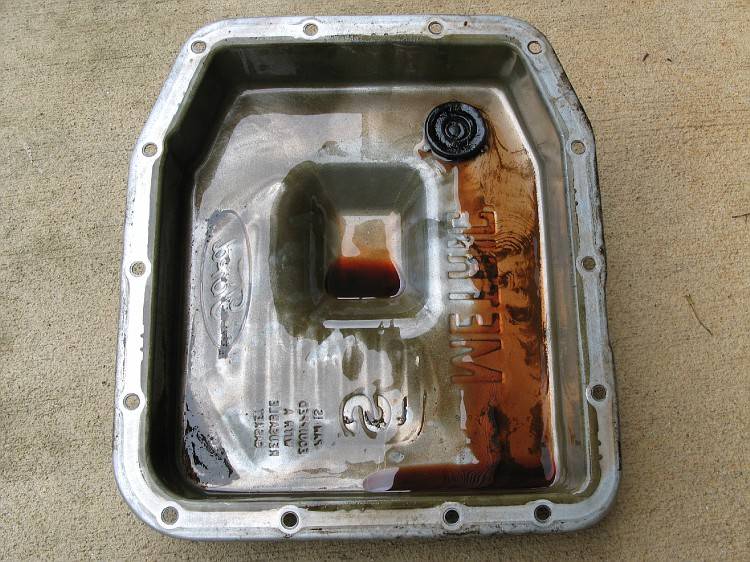

I was surprised how much crud was in the pan. Most appeared to be Arizona dust, but the magnet was covered pretty good IMO. Not what I expected in a 28k mile transmission.

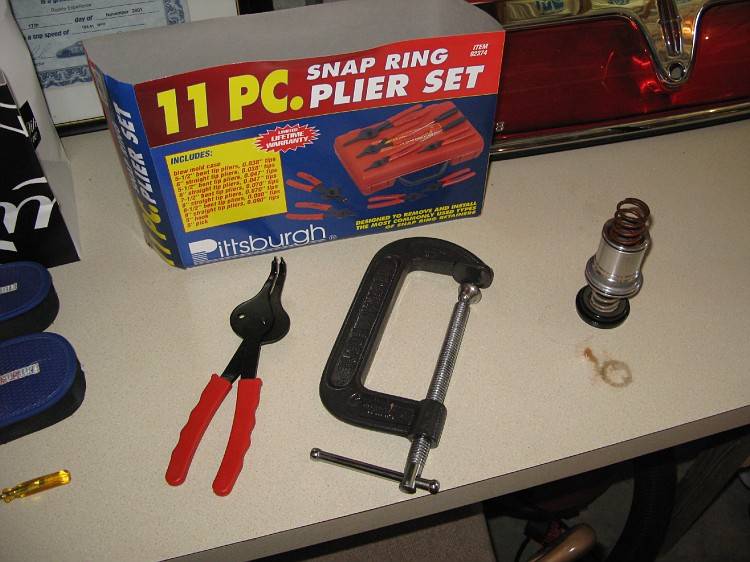

Replacing the accumulator was a piece of cake. I thought there was no way a 5 inch C-clamp was gonna fit where it needed to go, but it slid in there like it was made for it. Thanks HOTLNC!
I found a set of snap ring pliers at Harbor Freight that included the needed 11" pair. I used the pair with the angle tips. I'm all about quality tools, but didn't feel I needed to spend big bucks for this tool. The Harbor Freight set was a whopping $11 and included ?? Pliers.

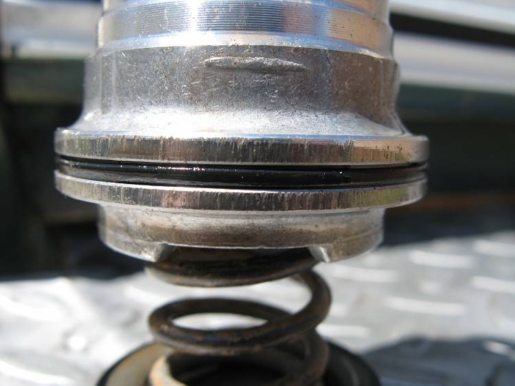

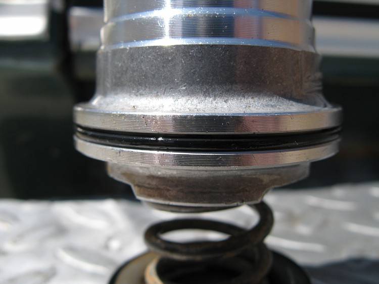

I could see some wear on the accumulator piston, but the inside bore looked fine. No broken springs, but I used the new springs to be safe.
(Other side)

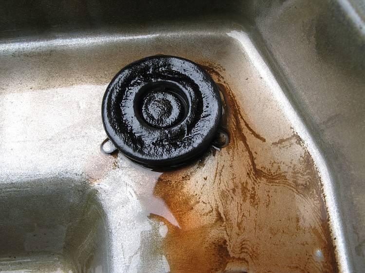

Note that when you remove the accumulator piston there is a good amount of fluid behind it. Glad I had my pan close by and my face outta the way!

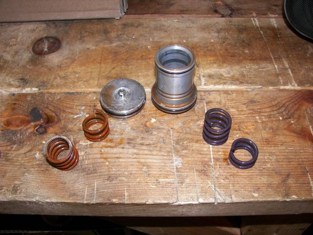

How easily the 1-2 accumulator comes out will depend entirely on the condition of the two springs within the assembly. Both of the springs in mine were broken, so there was no pressure on the accumulator. Consequently, it stayed in place when I removed the c-clamp. I ended up having to put a small self-tapping screw into the bottom of the old accumulator cap and use a pair of plyers to pull the base out of the valve body. Once I did that, the bottom spring fell out in two pieces, and I was able to remove the accumulator and the top spring.
Here's what my old 1-2 accumulator looked like. You can see the self-tapping screw in the middle of the old accumulator cap.
