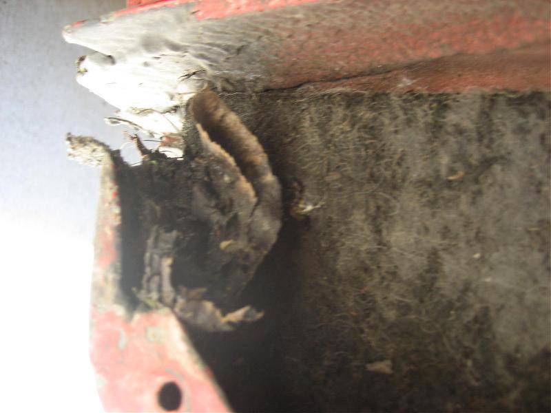

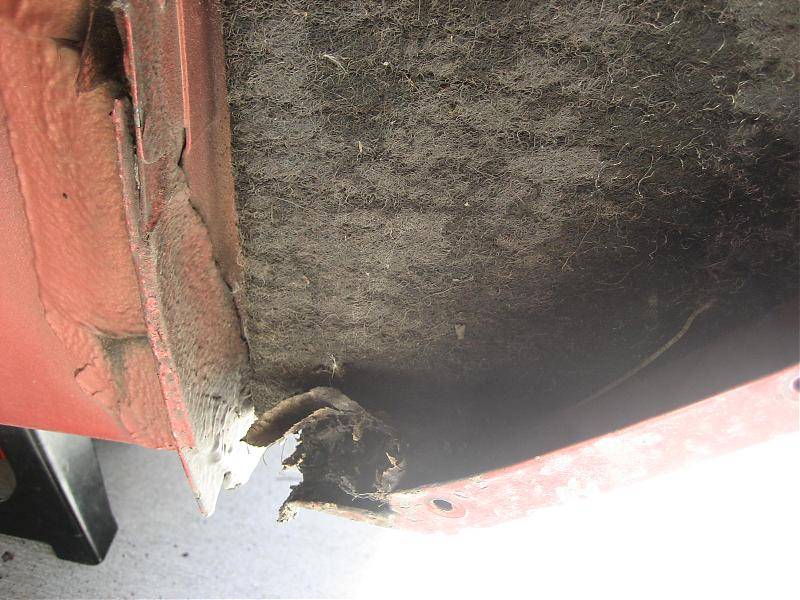

Im replacing the fuel filter right now, and I've got the wheel well guard off. Between the guard and the door theres a layer of insulation (sound-proofing?) At the bottom theres a bunch of leaves and grass and dirt. It appears the insulation is holding moisture in, which I expect could lead to rusting. So Im going to clean that crap out, cut the bottom couple inches of insulation off and maybe spray the metal with a coat of primer or red paint.
What do you guys think?
Posted by: unity
This has come up before, lots. But not recently so good thing you brought it up! Heck, I had trees growing in mine I think just two screw-tabs hold it in place. I washed mine good and let it dry a couple days in the hot sun. Then I cut off about 3 inches.

Posted by: 93' Blue on blue
Yeah, i removed those moldy things on mine and also the ones attached on the fender liners.

Did the same thing to mine.
Posted by: topher5150
My insulation is all smushed up making it more difficult to open the doors are they nessacary for a summer car
Posted by: unity
They seem to be just for sound-proofing.
