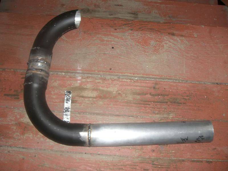

new cold air install...
idle sound clip...
filter in fender...
hole not cut completely...

ehhhhh nice positioning.... why the stock tubing with baffles? I'm sure there is a gain from what you did, but its just like an exhaust. To really see a difference you need to do the headers and cats. Looks and sounds good though
Posted by: JWerner2
Good work. You will want to do the rest of the plumbing for the intake sooner or later.
Why just a idle clip? That really don't show anything with the sound of the intake. You should at least give us a few revs.

i spent 60 buck after buying the filter and tubing... I only did a idle clip because i did strait pipes and got new tips. it souds alot better the intake really dows make any noise... Atleast i can't hear it over the exhaust....
I just used 3 inch exhaust pipe. started with 2 feet with a 90 degree bend in the middle... then cut it to fit..

What I would have done was bought the KKM or K&N adapter. They come with filters and you could have just used a coupler to hold the bent pipe you added to the adapter.
How is the pipe held to the MAF now?

The pipe is mounted to the mass air with a mass air flange that i made...just like a adapter but welded strait to the pipe.... no couplers needed
the only thing i want to do different is make a pipe strait to the throttle body, then paint it all gloss black not flat...grabbed the wrong can in the garage LOL

You would rather make the hole larger then obstruct the flow.
TDUB, as long as it is the right diameter it will work fine. I think I am going out today to find some pipe and do mine.
lincoln00, sorry I couldnt tell. That weld looks like silicone sealant or something.

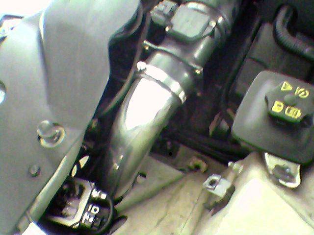

new pic after repaint and welding...
Posted by: JWerner2
Thats looking good. What did you use to cut the hole in the fender?

I'm going to buy the aluminum intake tube but I want to get a tube like the ones pictures so I can run it down into the fender to draw in the cooler air.

I used a dremel to cut the holes... still need to clean it up but i'm just lazy. It really has made a sound difference... I just really wish i had done it before removing the mufflers, so i could really hear what it sounds like.
Noticed a high rpm and high MPH increase... big difference at freeway speed...
