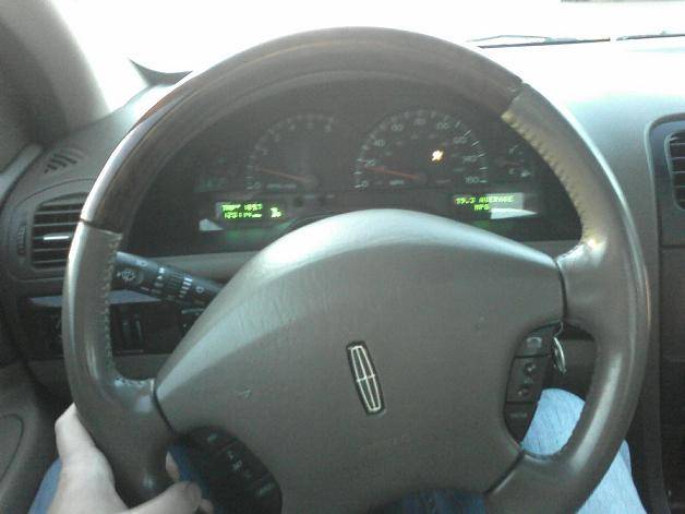

The last couple days while turning at low speeds, when the wheel gets back to straight, it felt like something is loose. After that though, it's tight. Last night the wheel sat straight, this morning I noticed that it is cocked to the left a little. Any idea what would cause this? I have not hit any big bumps or anything. I was just in there replacing the ball joints and hubs, nothing seemed loose. I just don't know what would cause this. Here is a picture of my steering wheel, I'm going in a straight line. Any thoughts? Please help, I'm kinda worried that something bad is going to happen soon.

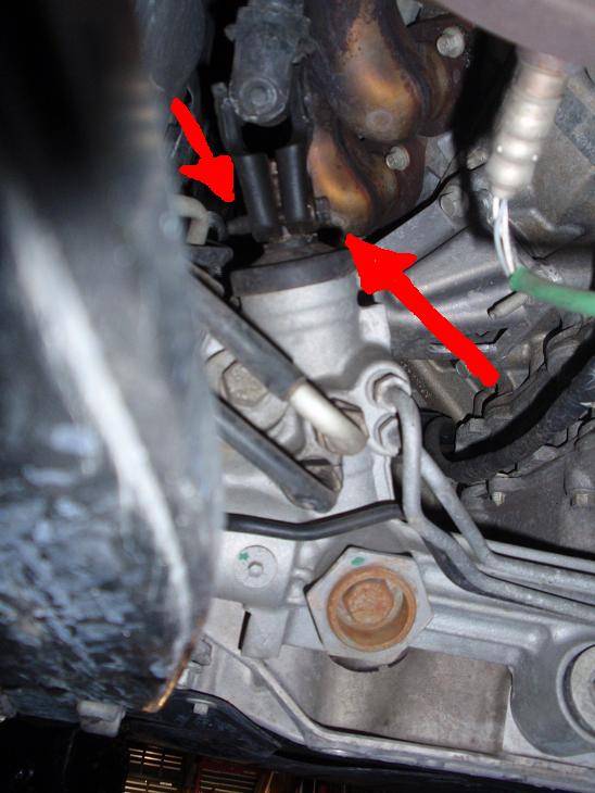

Is this the bolt you are refering to?
Posted by: 97stscaddy
That would be the one, yes.
There could be one more joint like that inside the car, not sure, but it would be worth checking out.
Id say what you need to do is get someone to turn the wheel back and forth a few inches at a time while you watch the components in the steering / suspension, for anything that moves but isn't supposed to.
