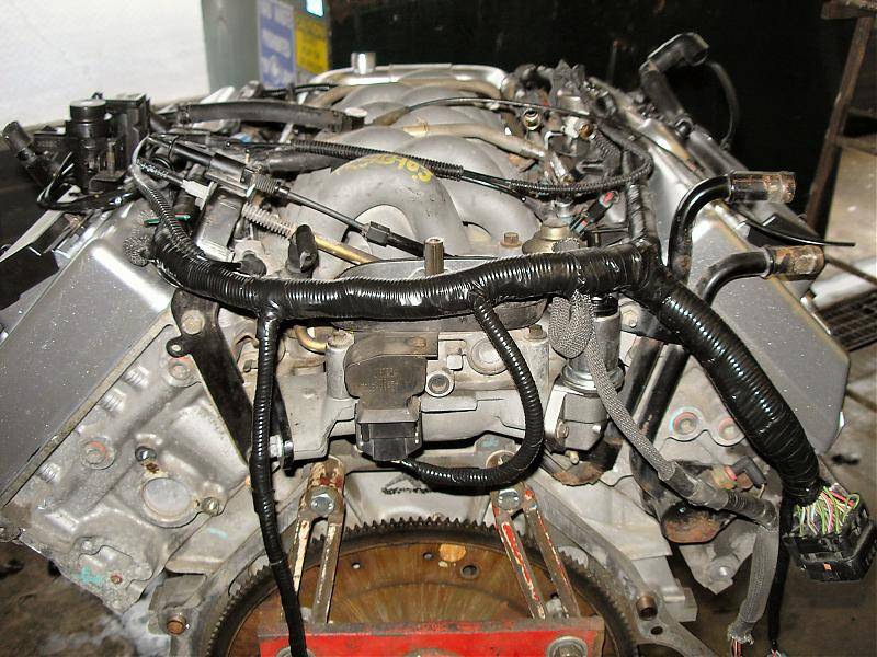

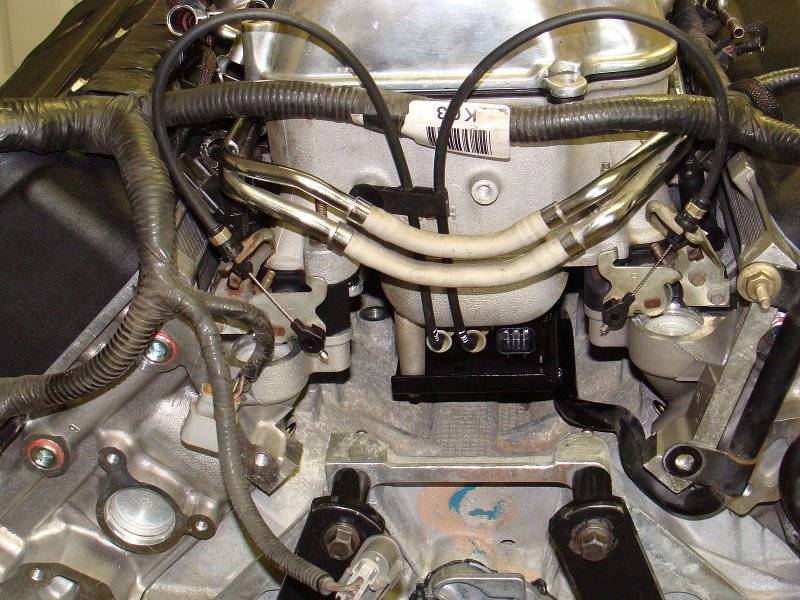

thanks you all this is my first mark 8 im a truck driver and thats why im not on line everyday but i read what to do but what does it look like when i look un der the hood im like damn n ever delt with this kind of motor by the way i do have msd coils and wires and 764s 3rd cat delet and flos can you you provide a pic of what i should be looking at
Posted by: chickenviii
2 tiny levers levers up against the firewall at the bottom of the intake/top of the head, theres gotta be a pic somewhere.........
NINJA EDIT!!!!!!!!!!! ok first up is the rear view of a gen 1 mark eng from project thundermark, and every pic i got is either too far away and that big wire loom is in the way, so im also throwing up a pic of mlschultz's eng, now his is a cobra intake that uses electric imrc's, so do gen2's and i think you got a gen1 but it gives you an idea where the levers are at. they should move over 3k
